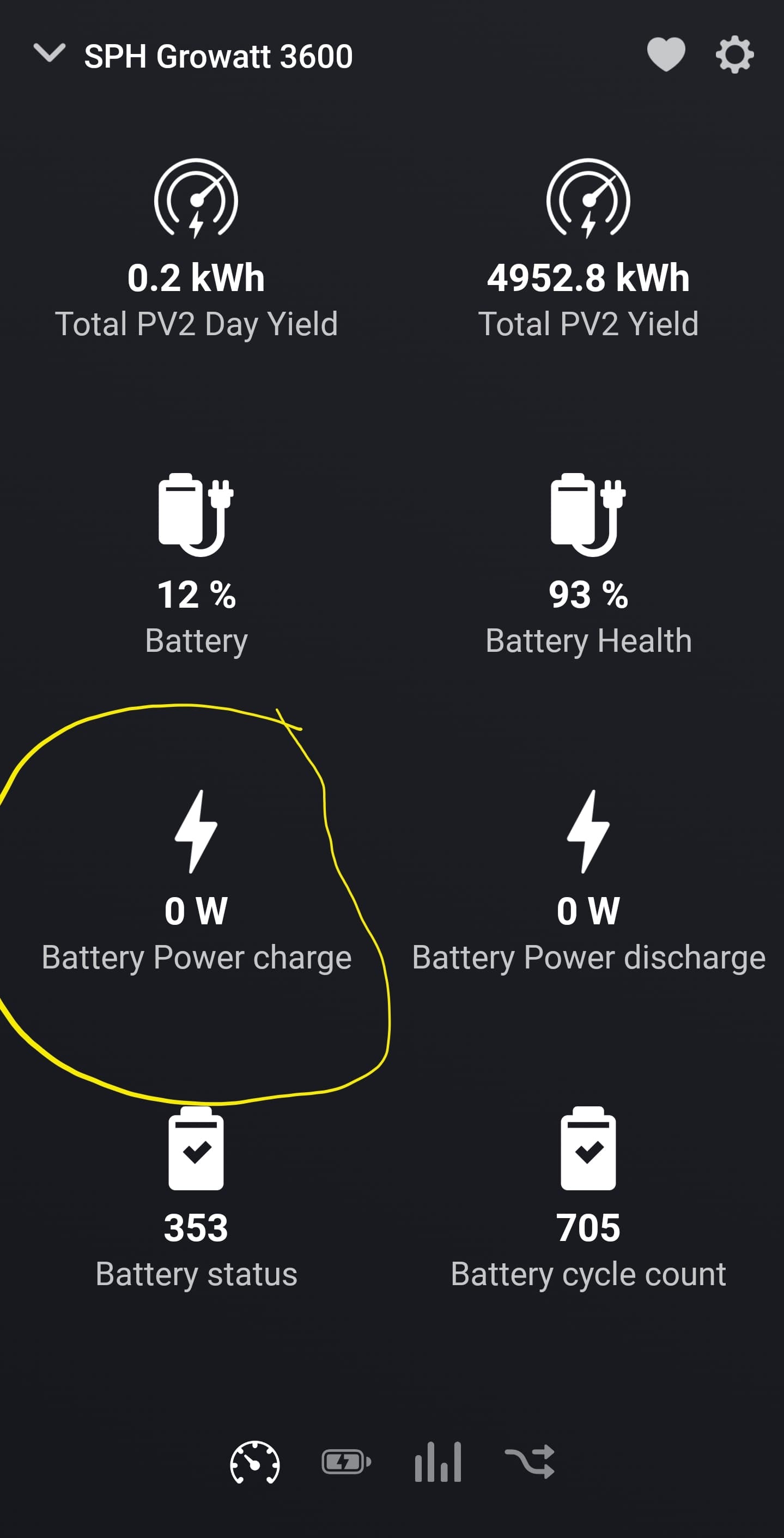

Is it possible to have a flowcard command that can charge the growatt battery ?
Br
Michael
strange reading since charge and discharge are both 0.
in any case several parameters are important;
  • charge from grid or solar?
  • required prio modes set or used?
  • other conditions for charging like min max batt % level
So 1st, how do you limit charge and discharge to 0?
