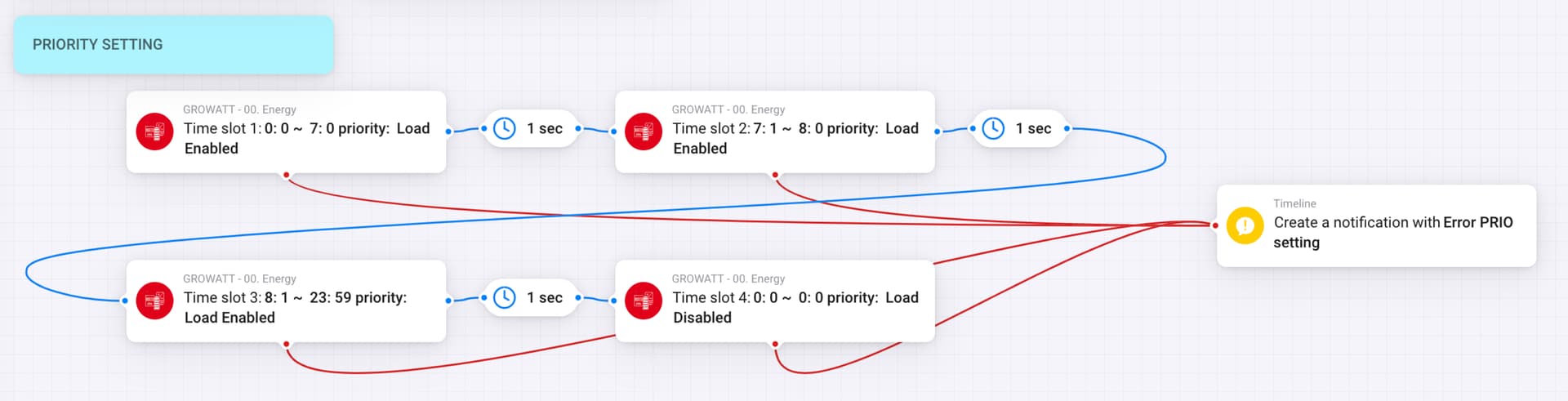

@Peav need to answer that one. We tested the settings for the app with this:
And it is a similar flow card I use, where I see the issues…from time to time.

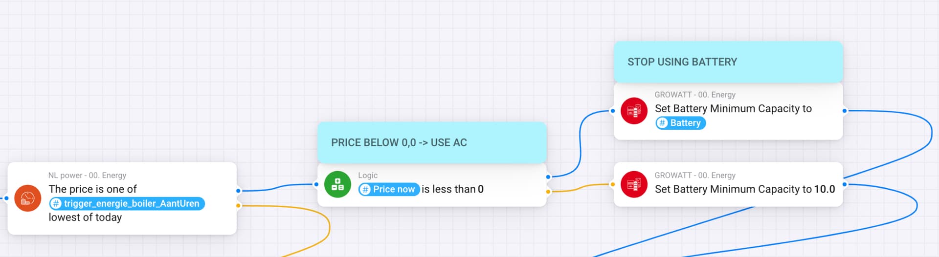

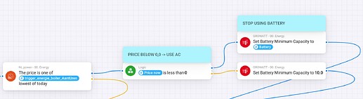

I have Growatt_MIN-3600-TL-XH. as from a data perspective they should be the same.
As long as I stay in Priority LOAD, I switch the min batt capacity also in the boiler module,
as soon as the 4 less expensive hours arrive AND the price is below 0,0 I switch the battery min capacity to the level of capacity, blocking the battery pack to provide power to the boiler and using the free of charge grid power. If there is enough battery capacity (another module) and the prices are low, the boiler is permitted to heat-up.
It functions flawlessly.
[EDIT] Note that if the minimum batt capacity is reached (or set and reached) and eventhough the priority is LOAD, growatt allows to use GRID power to restore the minimum batt capacity !!
With this in mind, you should have another look at the value of 100%.

@Phil_Bro and @Edwin_Biemond , thanks for the reply.
Phil, I’m trying to understand what I have been doing wrong to prevent the battery discharging. I have the priority set to “Load First,” and the “Batt AC Charge switch” (grid charging) is off. My understanding is that if I set the “Battery Minimum Capacity” to 100%, the battery should neither discharge nor charge from the grid right? Even though “Battery Minimum Capacity” is not #Battery like your example. Thanks for the screenshot, I shall experiment further according to your example (Set “Battery Minimum Capacity” to the current capacity)
Edwin, I don’t know. I have passed your answer to the PBTH developer. :slightly_smiling_face:
We had been testing this over and over and to my suprise, if prio is set to load and the batt min capacity is reached or some % below that value, the inverter starts to pump it up using AC power. This is proven many times. So if you set the min batt capacity to 100% and the real batt capacity is f.i. 15%, it will start charging upto 100% since that is the minimum the inverter has been told to keep. It is chinese logic, but for sure I have seen this many times. This is why I use the setting as per screenshot and not above the actual batt capacity.
So test this in the evening, or no solar power. Set the the min batt cap 2% above the actual and prio LOAD on. I have grid charging always OFF. I did some testing to charge battery when pricing is below 0, but since this occurs some times per year, I see no advantages. Additionally, if set to ON and for any reason the domotics are dead … it keeps on charging with GRID power. Not-done.
