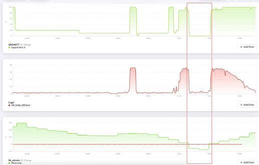

Today the first negative prices in my dynamic contract. And my solar panels are down. :clap:t2::clap:t2:
I see indeed, did you use the solaredge way or power by the hour and using flows?
Same here, Told Growatt by automated flow to disallow export during dynamic negative pricing.
Using Power by the hour. In SolarEdge it did not work. I run a beta so I made a case. Also the dynamic prices don’t work in the Solar Edge app.

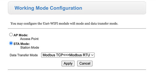

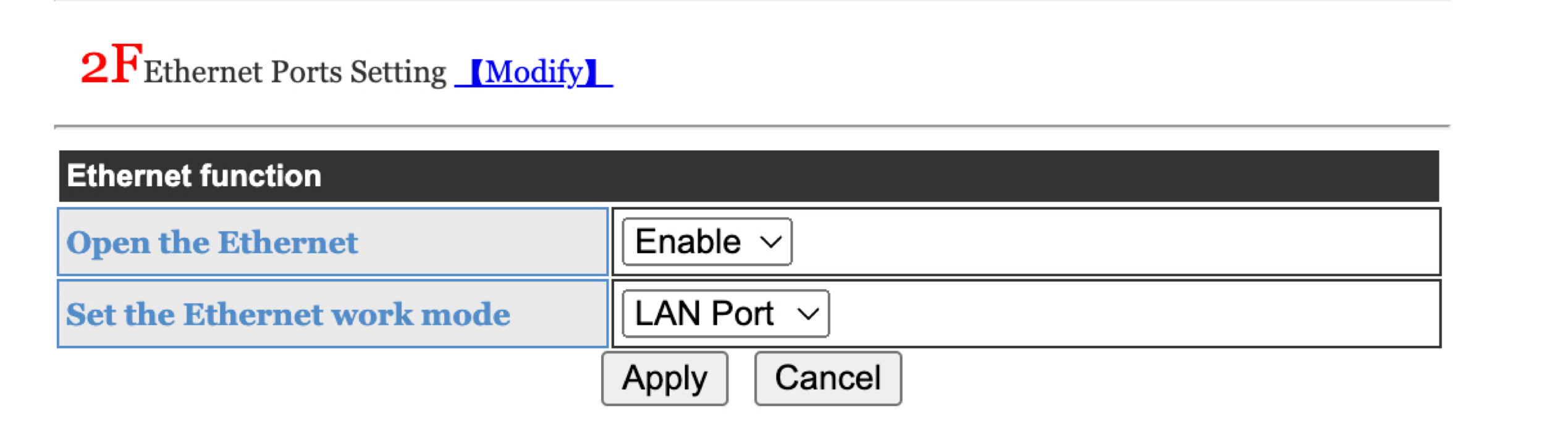

Hi, After 4 hours tinkering and reading all the posts I gave up. I connected the USR-W610 to the Growatt MOD 4000 TL3-XH. When I login into the W610 it receives data but unfortunately I cannot see the data in Homey. Any ideas how I can resolve this?
7f1e56e2-1760-45f5-80fe-581f2b6895ae. Thnx!
Hi Sander,
I have the same USR-W610 on my Growatt TL-XH. Allow some time (approx 3 hours) to put some settings screendumps here, might help you.
EDIT : screendumps ready
Thnx! I used the same settings (except voor AP because I do not use that) but unfortunately nothing. I connected the cables to pin 3 and 4 of the inverter, next to the cables of the power meter. Is this correct?
That seems correct
