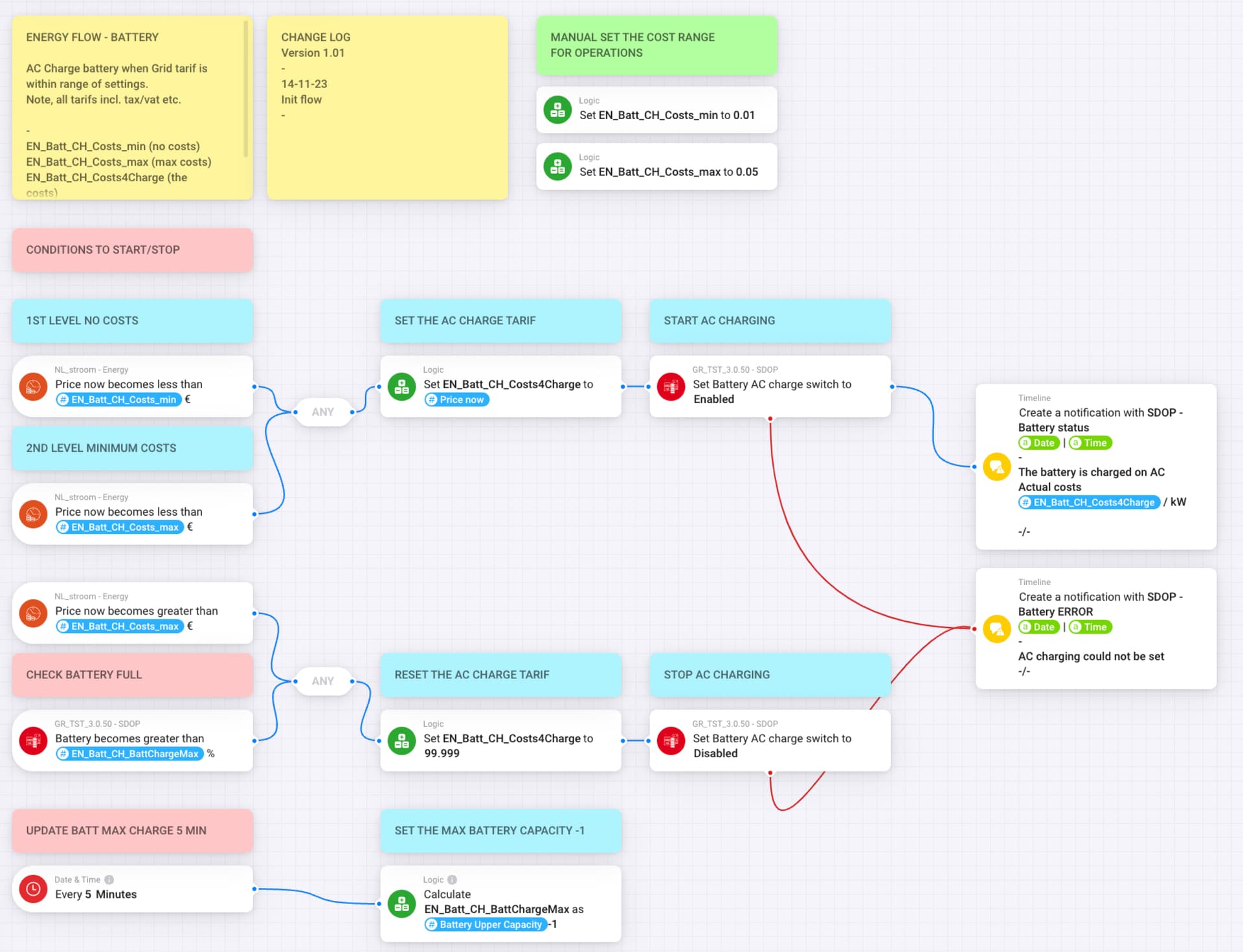

SIMPLE FLOW TO USE WITH DYNAMIC COSTS AND CHARGE BATTERY WITH LOW TO 0 COSTS
Just want to share my simple flow to control the battery charge when the costs provided by the grid are lower than zero or at a rate you put as minimum.
This is the first part of controlling the setup. Next part will be to avoid injection of the grid when costs are negative (you have to pay your own injection when negative in NL!) and a check on the max Voltage and stop injection (attempt to avoid inverter to shutdown as the grid delivers more than than the inverter max voltage setting). These events happen when the provider overloads, they put an extra Voltage peak in the grid, shutting down the inverters to avoid total overload. As a result your inverter will produce NOTHING and house load will be taken from the grid.
