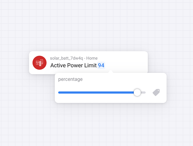

I was wondering if it would possible to add a random number as percentage in then flow instead of the four predefined ones?
Great work!
yes I can do that, only do triggers and show it as a sensor on device , already got a crash report from someone who did 99
Ow okay.
Then leave it this way.
So we can use it with these 4 predefined percentages and get some experience with it.
Thank you so much!
Can I buy you a beer?
no you are right, will change it , have to support 0-100 because if you change from solaredge menu it crashes when you use different values… like someone did with 99

yes, I added this as a test so you were able to test this easily. replaced it now with a flow action and allow now every value from 0 to 100. the slider was not working fine with 0 to 100, no label and hard to see, Enum with 25% steps was too restricted and received crash reports of people who used 99% .
so now only by flow trigger actions. so you can do power by the hour, check for minus 19c and do active power limit to 0% or calculate your own consumption with some P1 device and do 12% for example.
