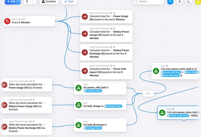

Do you know what is expected in upload function? The AC power output of the inverter or the DC input from the panels?
The app can upload your PV output every 5 minutes to improve the model.
The upload needs to have your PV output in kW!, most of the solar apps use watt, so you have to divide the output by 1000.
So AC output, as Solcast takes into account clipping

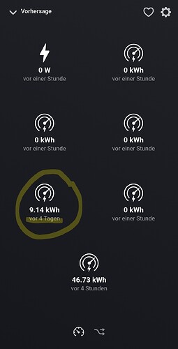

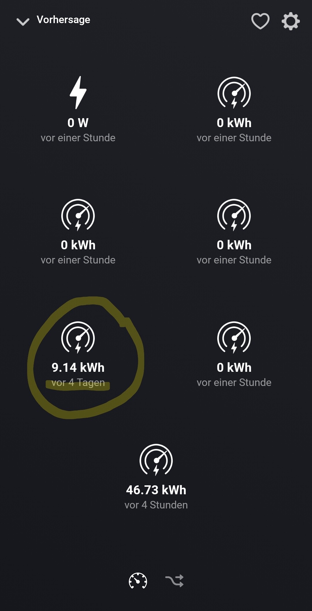

The forecast today is not updated since 4 days. Is it only me or is it a bug? Other values are updated.
Automatic polling is active with 10 calls a day (7 done for today).
Hi, today the daily forecast was updated.

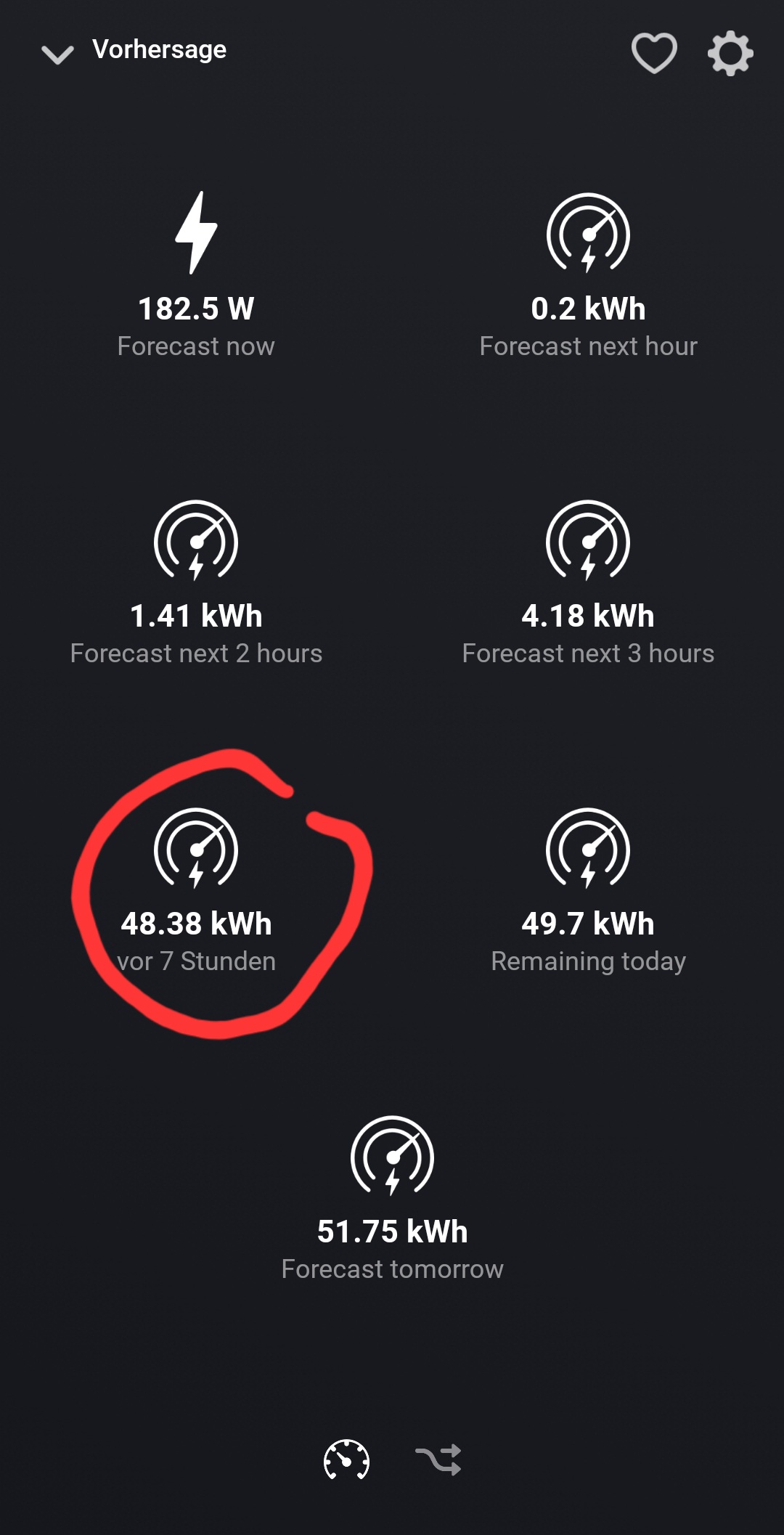

Remaining today gets updated during the day, but daily forecast not. Is this correct? So forecast is the original data at start of the day and if weather changes, the remaining data is updated (also higher than the forecast)?
Yes correct, remaining today can become more then the original daily forecast.
