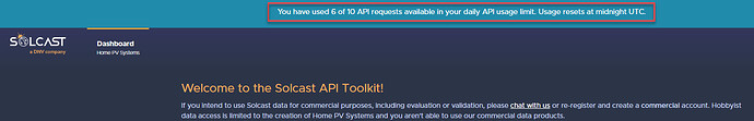

Hi Pieter, thanks for checking the logs. Weird, error 429, too many requests. I did retrieve the forecast today after 00 UTC, so after the moment the daily API-calls limit of 10 per day got reset . At the solecast website, when you log into it, the bar at the top shows the how many calls are made from 00UTC till the next 24h thereafter (see screenshot).
