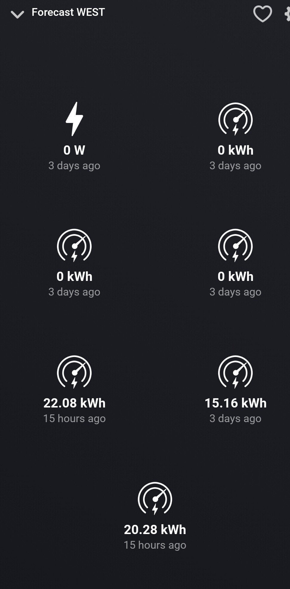

seems WEST is not getting updated, even if launched via same flow/trigger - except of values at midnight.
Do you see please anything obvious?
Maybe try to not update at the same time. Maybe a minute difference or so.
You need 2 different actions, one for 1 and one for 2.
