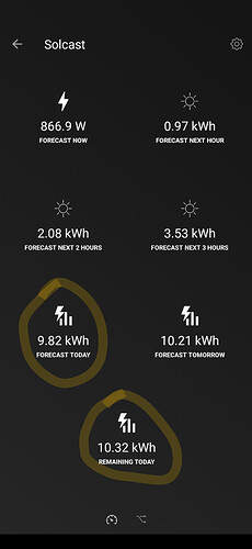

Hi @Pieterv123,
today I have following situation: the remaining kWh is higher than the predicated kWh for today.
Seems not logical to me or did I understand something wrong about those values?
I restarted the app. The daily value was updated, but not the remaining value.
Best regards,
Thorsten
The today value is retrieved at midnight.
The remaining today is retrieved every half hour, so it could be that the weather forecast changed, and you will have more sun then initially predicted
After a reboot the today value will stay the same, it will not update until midnight.
The other values should update, if it is daytime not during night hours

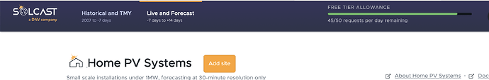

Thanks for the app, it works great except that the amount of API calls has been changed at solcast to 10 a day. This means the app stops working after 10 calls. I would suggest to either

Okay that is only for new users, old user still have 50 calls.

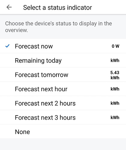

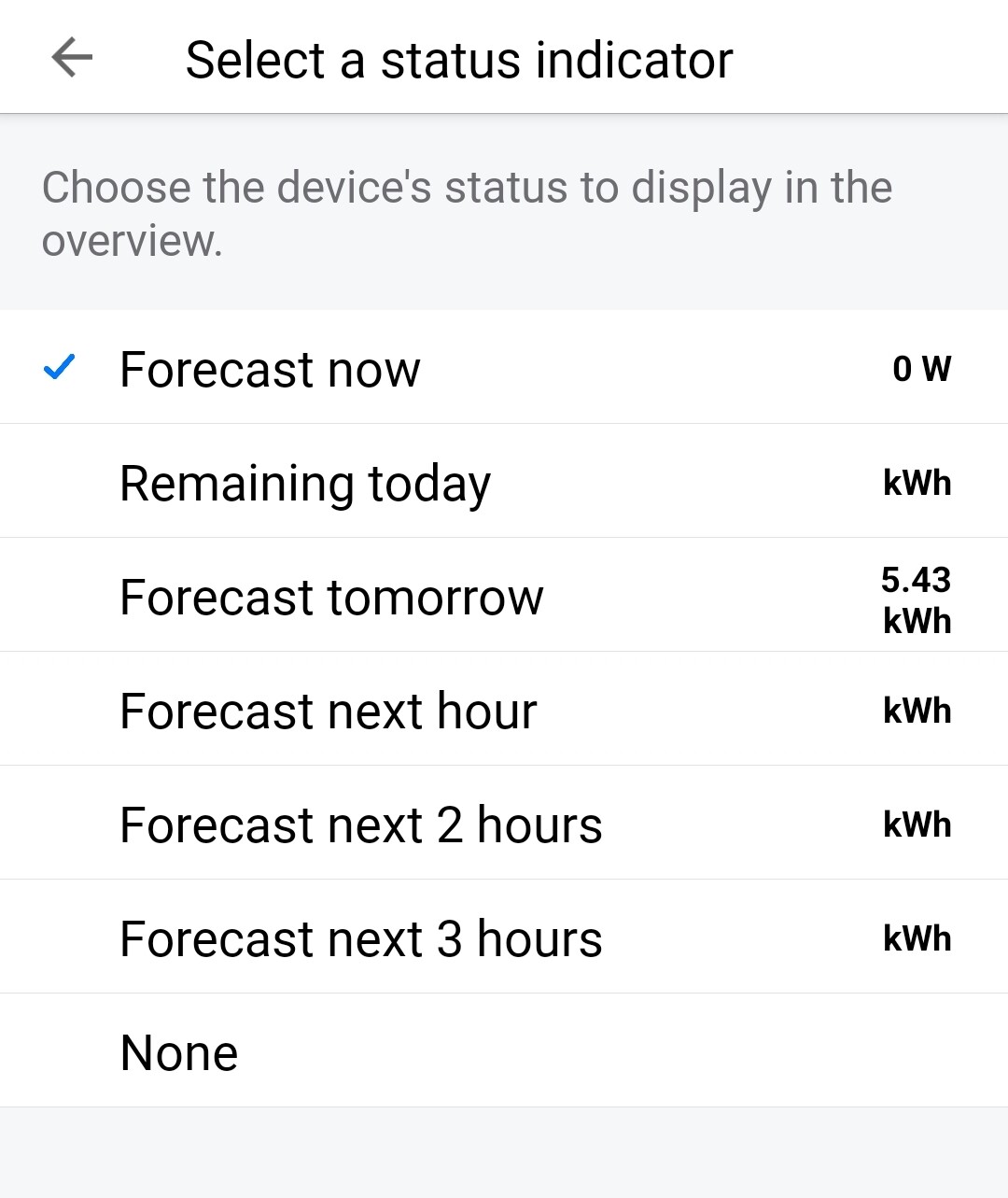

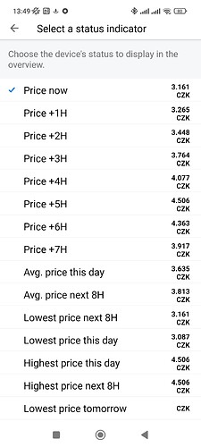

I mean that on the device tile, you select the desired variable you want to be dispayed on it. For example on the device Spot price in app “Power by the hour” you can displa any value it provides.

you can try the test version, Its a quick try, so could be some bugs hiding in there.
Test

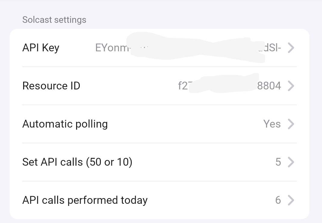

In the settings you have to mention how many api calls you have! (And afterwards restart the app)
I changed the capabilities, so you can use the device tile. (It was there before, but some people didn’t like it that it shows up in the energy dashboard, I think it doesn’t now)

New test version 3.1.1 with:
  • Ability to disable automatic polling (uncheck the checkbox in the settings)
  • Use a Flow action card to manual poll Solcast (so you can choose yourself when to fetch)
  • Bugfixes and keep track of API calls again
Cool the test app shows 2 decimals in flowtags too. Thanks.
Also thanks for Status indicator other values added. However I am missing Forecast today which i wanted to put :grinning:
It is in there, but I think you have to remove the device and re-add it.
I will fix this later that it goes automatically.

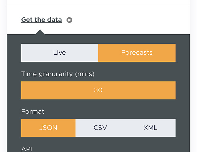

Should I use the JSON, XML or CSV in de API? I don’t seem to receive an update after first install.
Not sure what do you mean but you require API Key and Resource ID. Also please note that free version allows only 10 API calls per day
This is what I mean. What should I choose? Or is the API enough without the ‘format’ key? This format is in the API call.
Here you find the API - Solcast API Toolkit
And the resource ID you find in the URL → api.solcast.com.au/rooftop_sites/RESOURCE_ID ← you will see here - Solcast API Toolkit
That’s all you need.
