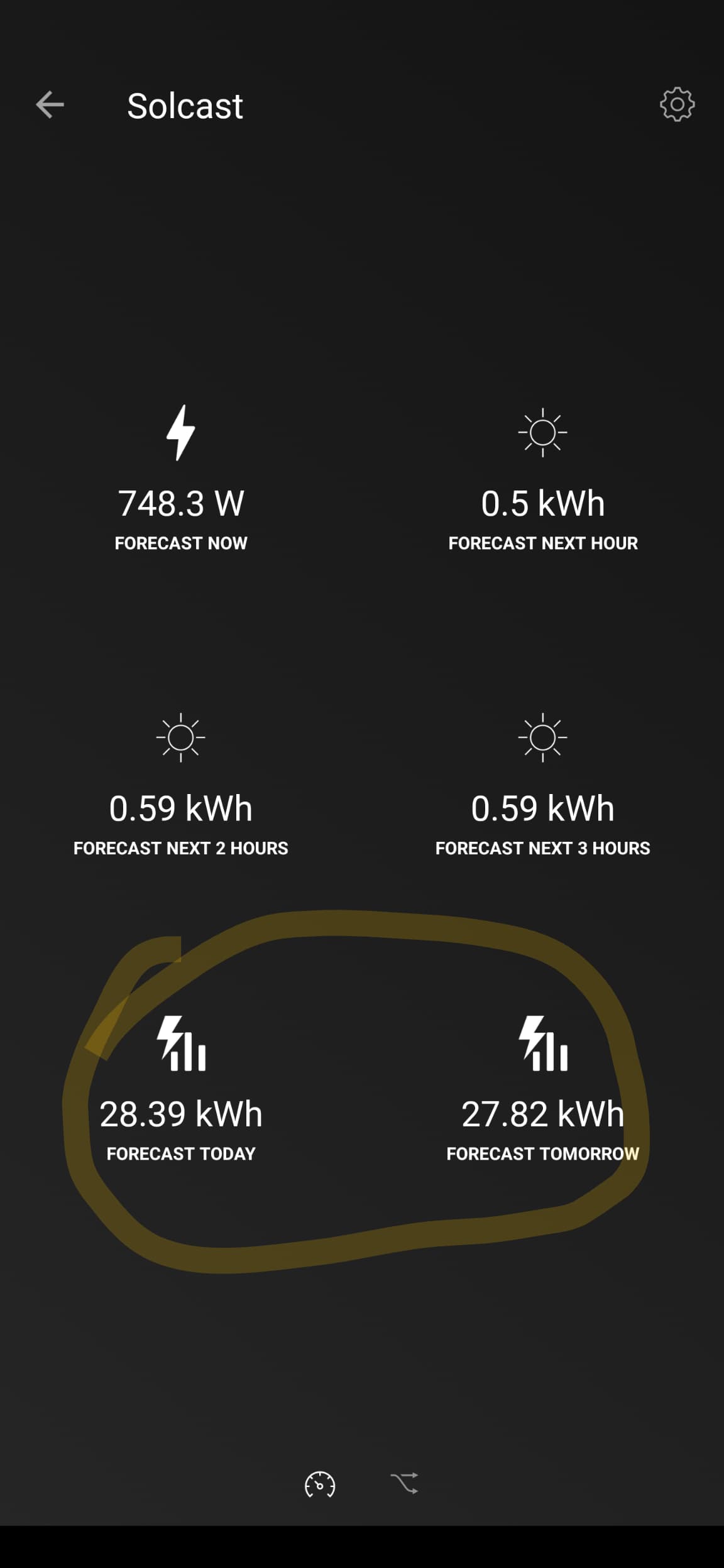

I did delete and add the device again. I assume we have to wait til tomorrow - currently the values for daily forecast are empty.
Do I need to reboot homey or anything else?
You will have to wait, but you can send me a diagnostic report again, so I can see if the error is gone
Interestingly the daily values have been set meanwhile. Wouldnt have expected that before midnight.
Here a new report: 6d80fa20-9787-46a7-9dbb-ce95ef3b3633
Unfortunately the values did not change after midnight :thinking:
Actually in your previous log, everything looked good.
But the fact that the daily values were set at a different time, makes me think it is a homey thing.
Try rebooting homey, and afterwards check if your location is correct: settings - location.
And check your timezone: settings - general - about
I did restart and check location and time before and after rebooting homey. Those values look ok. For the location the option ‘location automatic…’ was set (last option in the location dialog). I assume it is ment to be called ‘set homey location automatically’. Unfortunately the German translation is too long and the text has been cut off.
Whatever, I deactivated this option as this might cause the problem I have?
Really strange. I deleted the solcast device several times and readded it. First the daily values are empty. But every time after the first 30 minute cycle the daily values are set. :person_shrugging:
I checked the location and time settings and those are still ok.
I also recreated the API key, but this also didn’t work :person_shrugging:
Now the sum of 50 API calls are exceeded before 8 pm.
Can you help?
