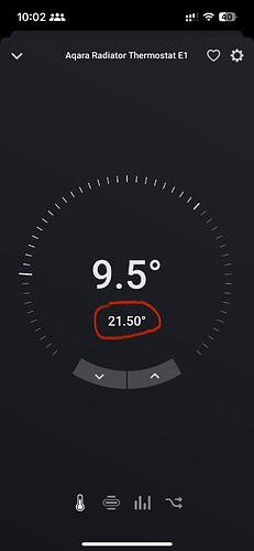

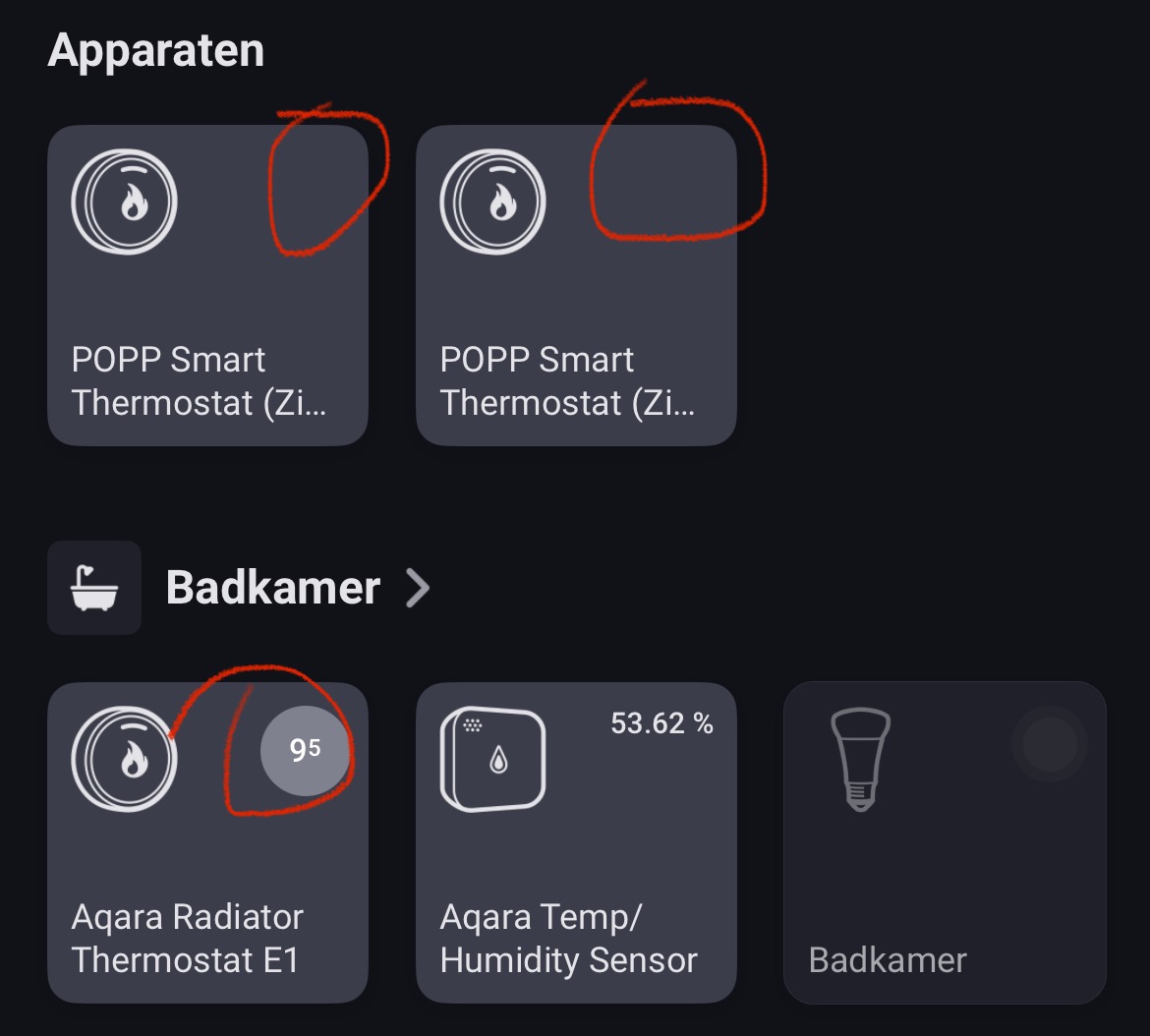

First, thanks for this app! I was able to connect two TRVs that are on my ST hub. Question / request on this integrations:
  1. could you add the temperature sensor in the icon overview
  2. could you add the temperature sensor in the device overview
  3. the device overview doesn’t change from color when you increase the temperature setpoint above the measured temp
Below some screenshots compared to another TRV that is integrated by Matter and connected by Aqara Hub
