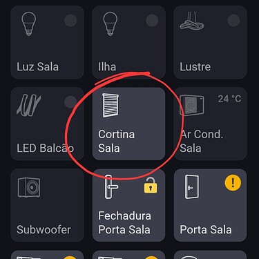

Hi @Adrian_Rockall , I have a curtain integrated with homey via smartthings and I don’t have the opening percentage status. Is it possible to check this?
Could you send me the logs from the app settings pages.
Yes. Log already sent.
Hi @Adrian_Rockall , I sent logs again to check for lack of curtain status. Any news?
Sorry, work has been manic lately so not had time to switch on my PC for a couple of days and it’s difficult to view the logs on my phone.
I will do my best to look this evening.
OK, so the reason it’s probably not available for display in the tile is it uses a sub-capability called windowcoverings_set.real. The reason for that is SmartThings can report the position using two different settings depending on the device. Some devices use windowShadeLevel and some use switchLevel so I had to differentiate between them so the app knows how to get and send the state. The reason switchLevel got the standard capability is it was the first one I saw and the other one was reported later.
So, unfortunately, that is a limitation in the app unless we can persuade Athom to allow sub-capabilities to be shown on the tile.
Ok, since there is this limitation, I appreciate your effort and time in helping. Thanks for the clarification.
