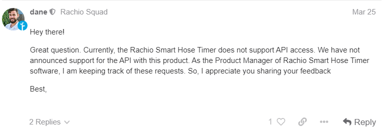

No API yest for Smart hose
Hi @Martin_Verbeek
Are you by any chance planning to build the smart hose integration?
Last time I checked Rachio had not added Smart Hose to their API…
Still the case… loads of people asking for API support of the hose.

Hi Mathieu, looks like an API is available now for smart hoses. As i do not plan on buying one, is it possible to create a user/password for me to check out with your environment if it can be created into Homey? (that is if you still own it)
