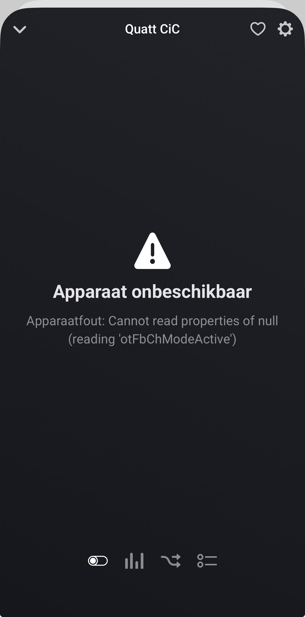

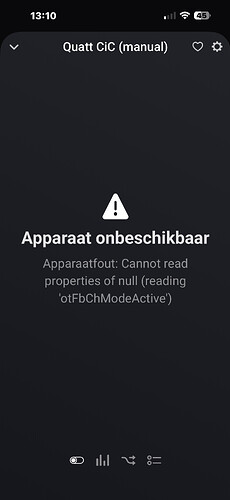

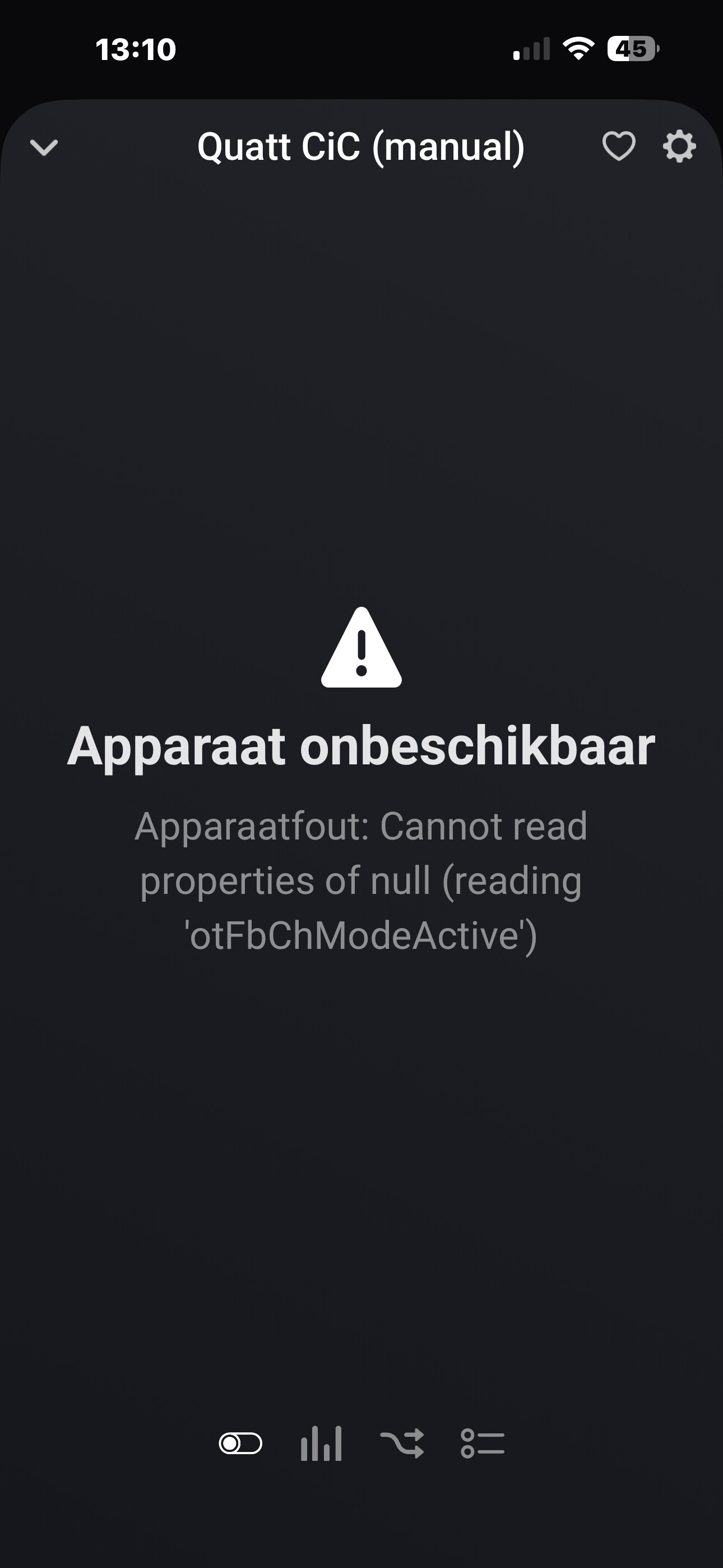

Somebody aware
Of a
A fix for
This message?
Hmmm, I don’t have this problem but I’m running my patched Quatt app which also has null/undefined checking for params (comes with the fix for the null value for the boiler)
I have the same error but haven’t found a solution for it yet.
