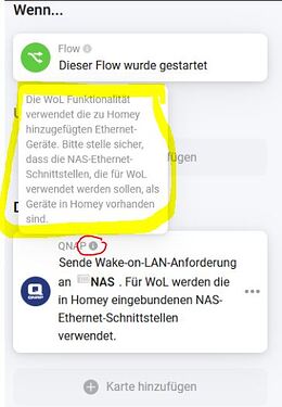

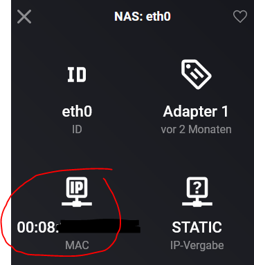

Hi, have you added one of your ether adapters as device to Homey? The app needs to know the MAC, and that`s stored in the eth device.
See the information in the flow (question mark).
In the mobile app:
Unbenannt
In the WebApp:
Just add the Eth interface to Homey:
grafik
Because it stores the MAC which is needed for WoL.
grafik
Hi Ronny,
That did the trick, many thanks!

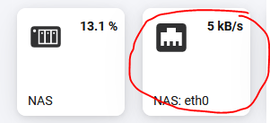

Could someone with 2 QNAP connected to Homey confirm this issue, please?
I have only one to test.
grafik

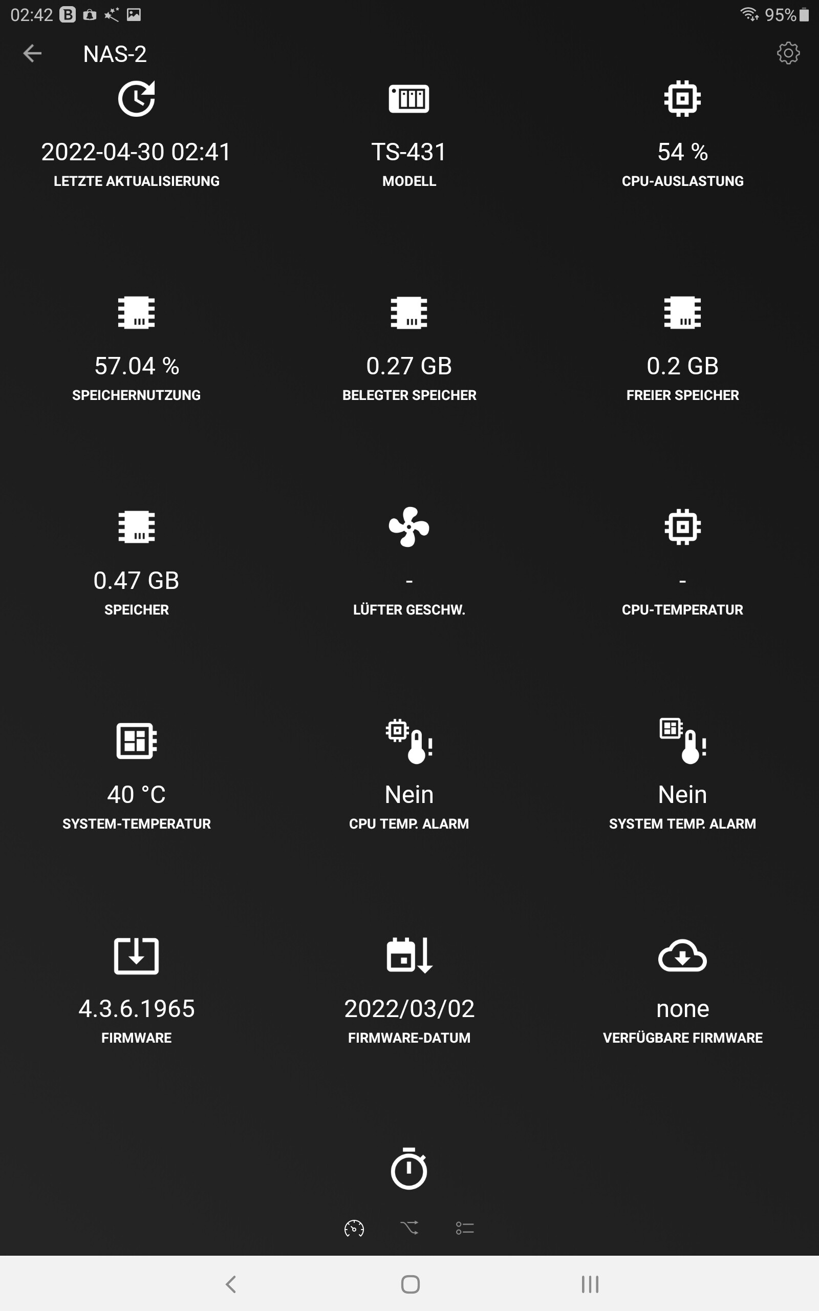

Screenshots from the two NAS sensor views would be nice. Even if the data for each NAS is correct.
Many thanks.
I am checking this:
I definitely have different values.
