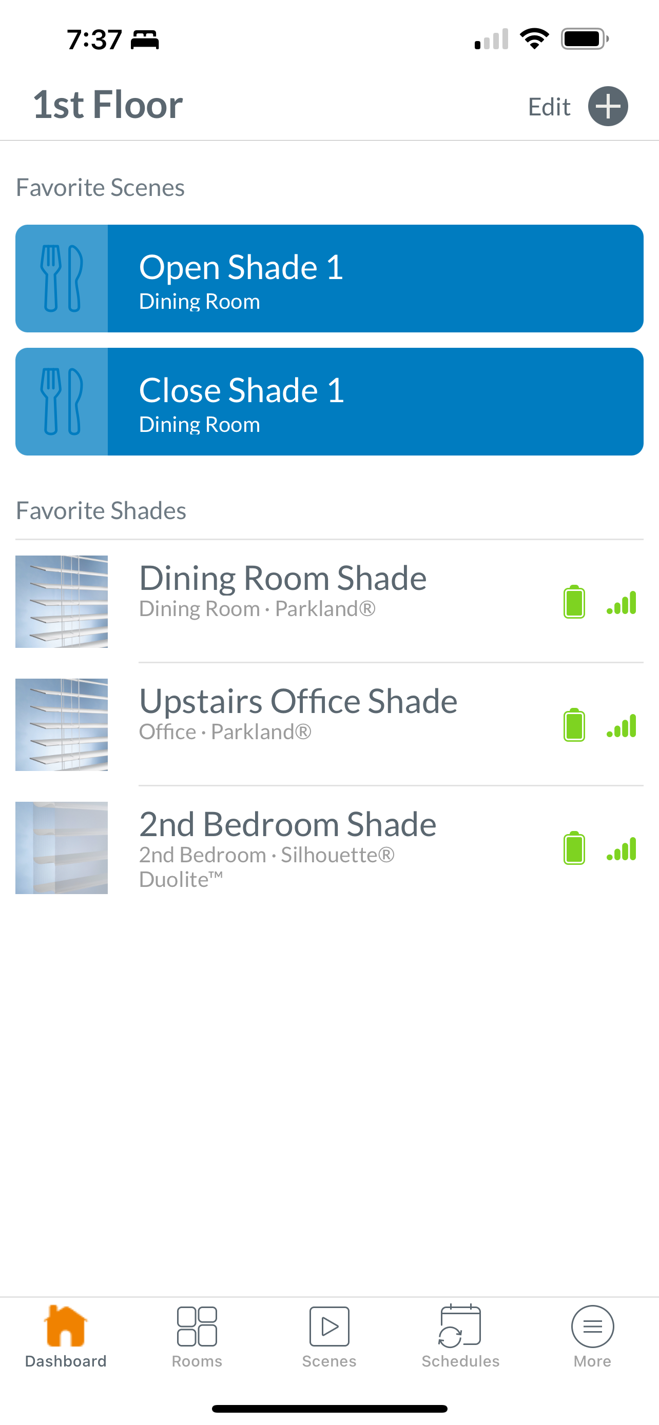

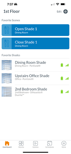

I am running the Powerview App version 2.7.9 and Gen 2 Hub and Blinds.
I installed the hub:
However, when I go to add the shade, I get the following:
Here is the diagnostic report: f2f6c7da-5205-450b-817f-a517a053d2a1
I saw someone above had this issue and the version update fixed it. I am at the latest version. Any assistance would be appreciated. Thanks!
