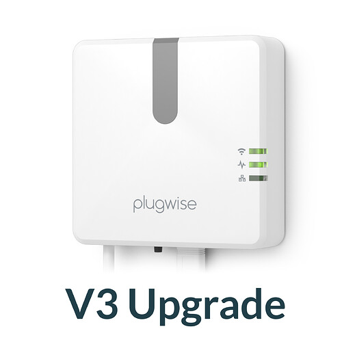

Plugwise went bankrupt end of 2020 and was taken over by Anna Technology BV. They dropped the support for some devices. I believe the older versions (with the WiFi antenna) are not actively supported anymore. If it was running it should keep pushing live data, but all the history is unavailable.
I found this out by accident because yesterday i used the app at first since a long time and got a server validation error. Upon searching i found out the above.
I had mine upgraded today for €15. Fortunately all history is still there.

Plugwise support too said that this will proof difficult… (and offered an v3 with a discount).
