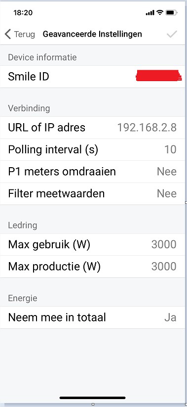

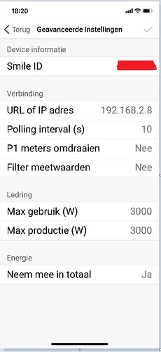

Hi Robin,
When I would like to see ‘Low tariff = YES’ in my Homey screen, what advanced setting should I activate?
Mmh. Maybe I did not implement that in the Smile app :grimacing::sweat_smile:
In that case you could delete the device and select the right options during re-pairing.
But you will lose all your history/insights and it will break existing flows…

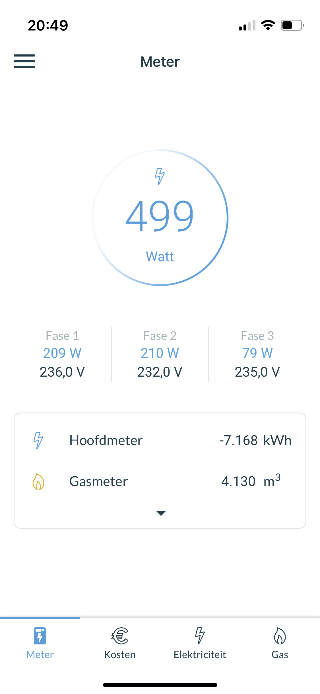

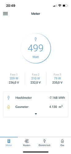

Plugwise added some nice information in the Smile. The power is visible per phase, and also the voltage. If possible, could you add this to the Homey app please?
Ah, interesting. Ill check it out when I have some time.
