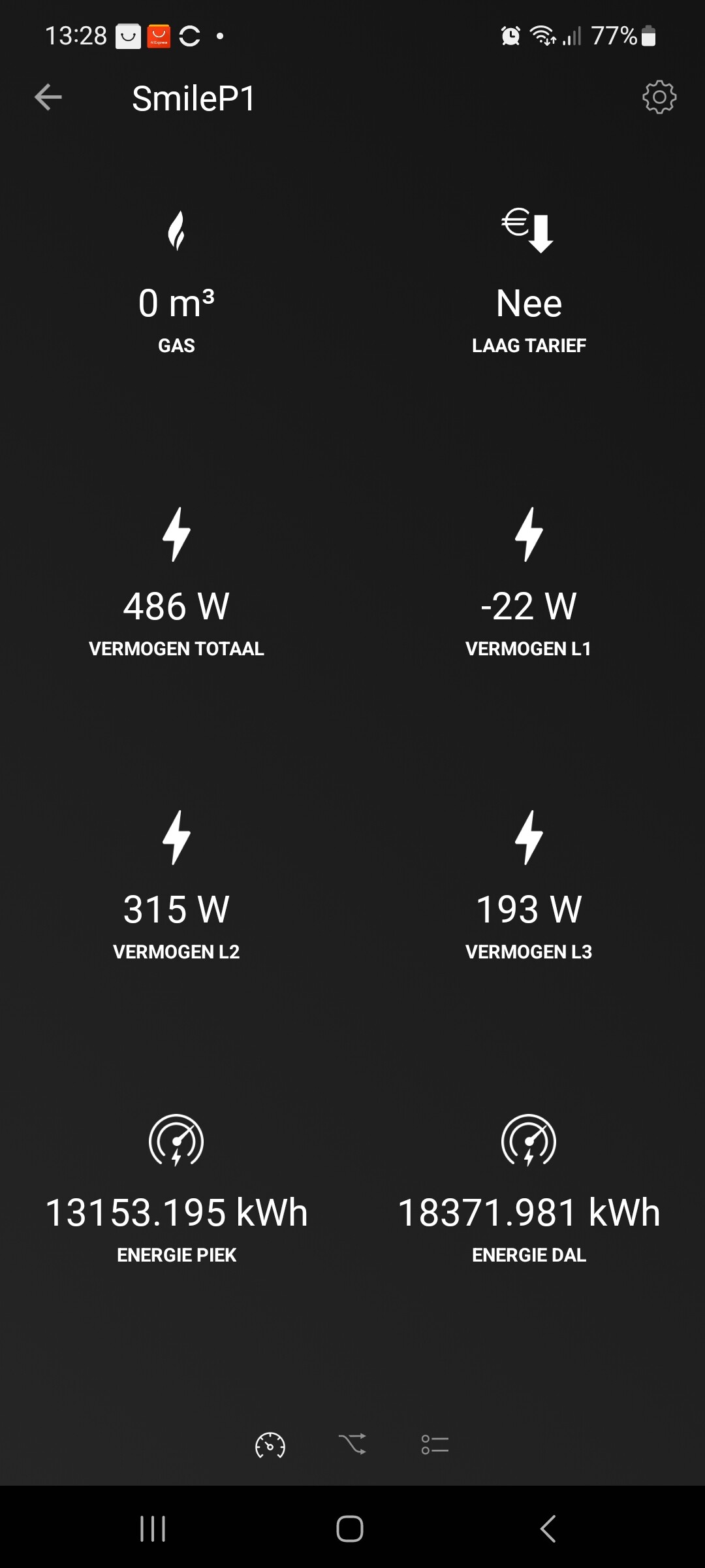

Just installed it. The Smile took a minute to migrate (red triangle was displayed), and then showed the correct values. Also the current amperes, voltages and power per phase. I will check it again later tonight or this weekend to see if the app is stable, but first impression is great. Thank you Robin!

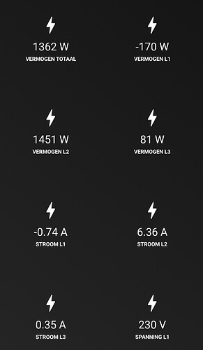

Can you share a screenshot of the info you now have?
Sorry for the delay, as I live in the south of our country, you can imagine there is a small event this long weekend that is slightly more important then checking my homey stuff… ![]()
But this looks absolutely fabulous:
