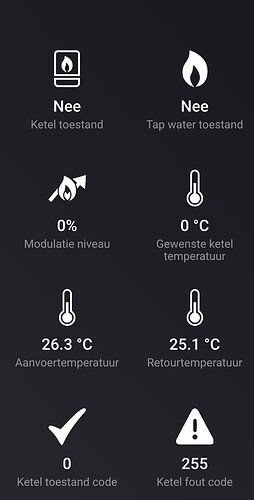

In your App the the 'gewenste ketel temperatuur" is shown:
On my Remeha Tzerra and Calenta systems I have set the central heating water to 48 and 60 degrees (the shower water is 65 / 65). In the App these numbers are never met. If the CV is running I get 35 / 45 degrees.
What does the 'gewenste ketel temperatuur" represent, if it is not the value I have set the central heating water to?
Thanks!
@Eternity this shows the actual operational temperatures inside the CV.
Desired temperature is the temperature setpoint the CV is aiming for at that moment in time to reach in the supply temperature (aanvoertemperatuur).
In below example: my heatpump is operating at 100% modulation level with intended supply temperature of 35 degrees. Actual supply temperature is 34.7 degrees and return temperature is 28 degrees.

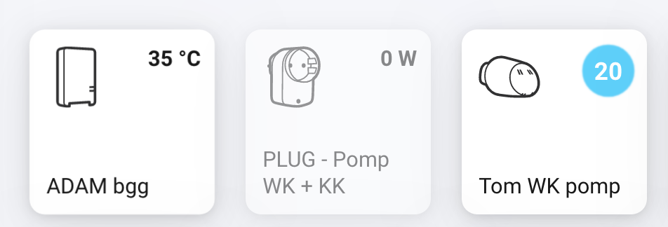

Would it be possible to select the status indicator for a TOM valve. It now shows the setpoint (shows 20 degrees in the screenshot), but that can not be set to valve open % or actual temperature. That would be handy :slight_smile:

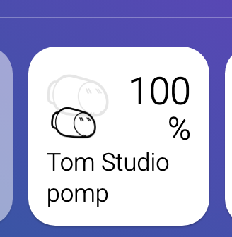

In Homeydash I can select the valve %
Schermafbeelding 2021-10-23 om 12.49.30
Unfortunately the current Homey apps SDK does not allow this.
Devices with the thermostat class will always show the temperature setpoint and the color is depending on the delta between actual temperature and setpoint.
