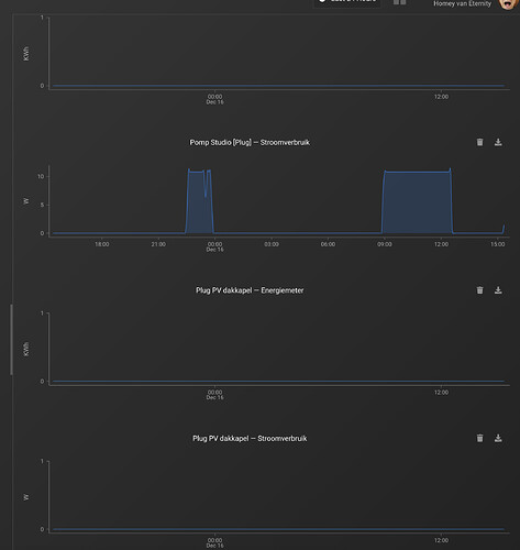

In my case I see that the PLUG report negative values:

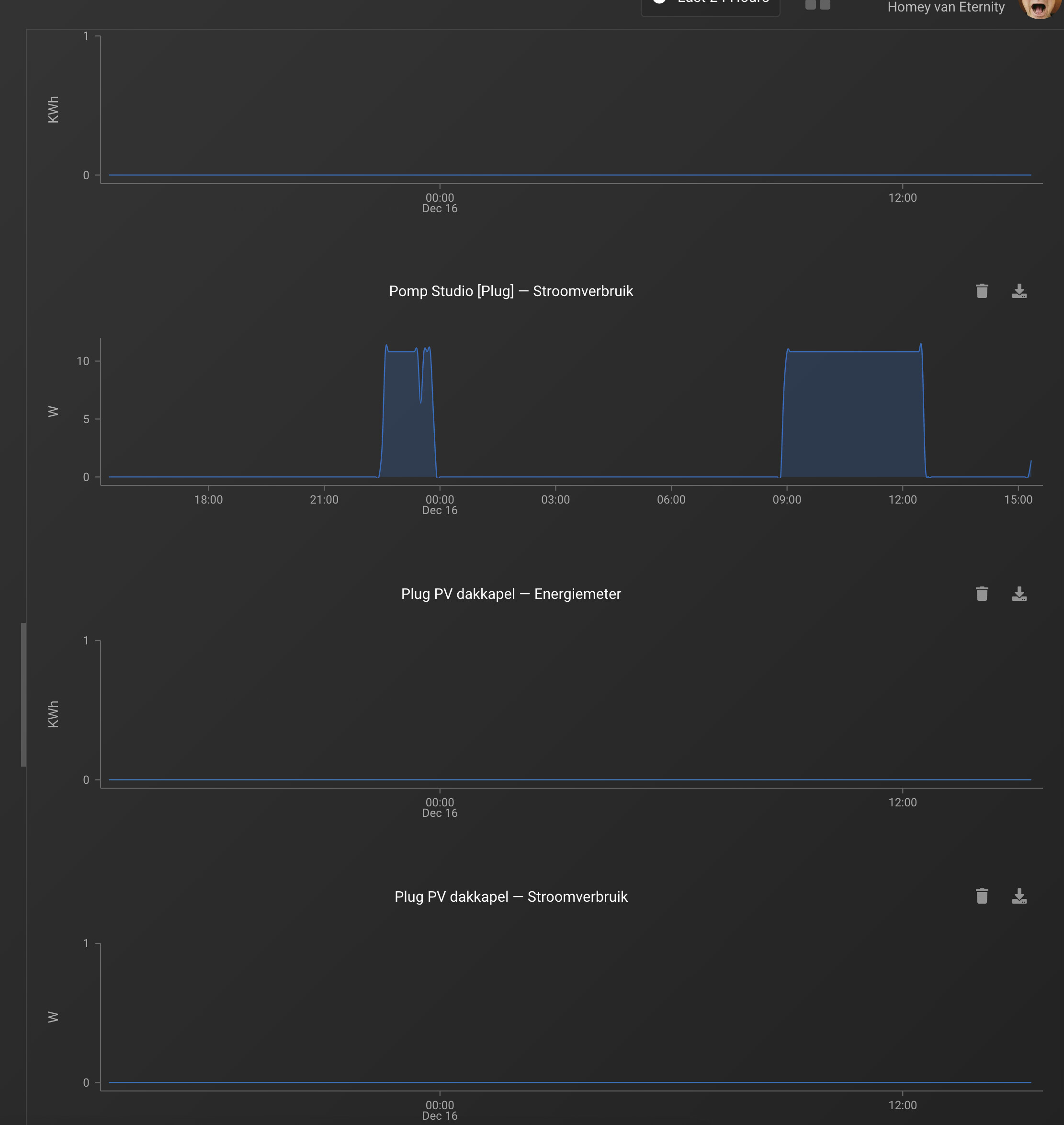

Schermafbeelding 2020-12-16 om 15.18.16 from my solar panels. This was also something I wanted. Unfortunately, the negative values from the PLUG are not seen in Homey tags, only positive:
Schermafbeelding 2020-12-16 om 15.20.37
Also, it fails to show the amount of energy used (energie meter). That value remains empty
No big deal, just letting you know :slight_smile:

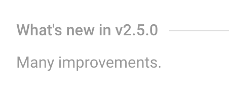

Athom’s Plugwise App has been updated.
Schermafbeelding 2021-05-05 om 15.13.28
Very helpful update notes… ::rofl:
