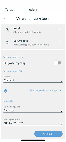

Nope that’s a different setting ,
The profile comfort

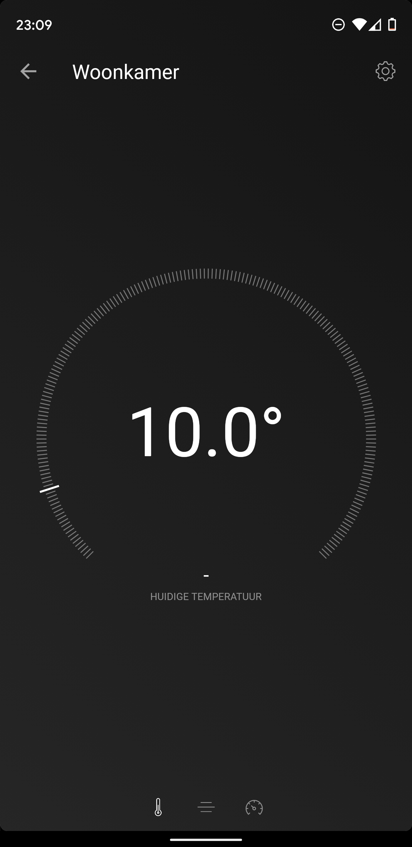

Only thing I noticed is that my zone is not showing the current temperature. Is this something I have to change a setting for? It’s just showing ‘-’ there.

Yes it is sending the temperature. In my plugwise app on my phone it’s showing this Temperature correctly.
In your previous message you said it didn’t show?
@Robin_van_Kekem my apologies for this late reaction, must have missed a notification there.
Also sorry for the confusion. What I mean is that if I use the application made by Plugwise to control the adam on my phone I see the temperature displaying correctly.
If I use the Homey app, than it’s not showing, only ‘-’, !

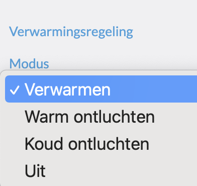

Perhaps the reason is, that I have selected the heating system in the Adam settings as “verwarmen”. In the manual it is mentioned that I should select “Plugwise”, but it is not available as an option.

Thinking a bit further; the ‘Plugwise’ setting might only be available if you have an Opentherm thermostat hardwired to the Adam. The options makes it possible to ‘override’ that thermostat and use Adam as the controller. I do not have a thermostat hardwired to Adam… I bet you neither :slight_smile:
UPDATE
I got a reply from Plugwise. The setting has been removed from and is replaced by the 4 options listed: “Verwarmen, warm ontluchten, koud ontluchten of uit.”
Het was niet altijd even duidelijk wat er met de Plugwise regeling bedoelt werd.
Wij hebben dit verandert in modus: Verwarmen, warm ontluchten, koud ontluchten of uit.
Hier moet deze nu op Verwarmen staan.
Ik zie dat de ketel aan is gesloten als OT, dus dat is goed. Enkel kan iedere ketelmaatschappij zelf beslissen welke gegevens er worden vrijgegeven en welke er aangepast mogen worden.
