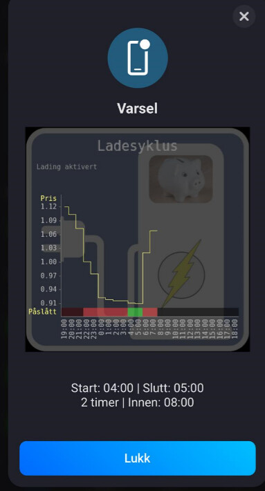

Here’s how you do it.
You install the homeyscript app. Insert this THEN card:
You use the JSON-variable token @frodeheg kindly has provided and insert it as the argument:
Then you paste this code:
//Get charge data text
var parsedData = JSON.parse(args[0]);
var startTime = new Date(parsedData.cycleStart);
var estimatedEndTime = new Date(parsedData.cycleStart);
var cycleEndTime = new Date(parsedData.cycleEnd);
// Function to find the first non-null index in array
function findFirstNonNullIndex(array) {
    for (var i = 0; i < array.length; i++) {
        if (array[i] !== null) {
            return i;
    return -1;
// Function to count non-null and non-zero elements in array
function countNonNullElements(array) {
    var nonNullElements = array.filter(function(element) {
        return element !== null && element !== 0;
    return nonNullElements.length;
// Function to find the last non-null and non-zero index in array
function findLastNonNullIndex(array) {
    for (var i = array.length - 1; i >= 0; i--) {
        if (array[i] !== null && array[i] !== 0) {
            return i;
    return -1;
// Find start time by finding the first non-null index in originalPlan
var firstNonNullIndex = findFirstNonNullIndex(parsedData.originalPlan);
startTime.setHours(startTime.getHours() + firstNonNullIndex);
var startH = startTime.toLocaleTimeString('nb-NO', { hour: 'numeric', timeZone: 'Europe/Oslo' });
// Estimated end time = cycleStart+last nonNull index in currentPlan
var lastNonNullIndex = findLastNonNullIndex(parsedData.currentPlan);
estimatedEndTime.setHours(estimatedEndTime.getHours() + lastNonNullIndex);
var endH = estimatedEndTime.toLocaleTimeString('nb-NO', { hour: 'numeric', timeZone: 'Europe/Oslo' });
// Extract the deadline time
var deadlineH = cycleEndTime.toLocaleTimeString('nb-NO', { hour: 'numeric', timeZone: 'Europe/Oslo' });
// Number of non-null elements in ORIGINAL plan = Originally planned number of charge hours
var numPH = countNonNullElements(parsedData.originalPlan);
// Number of non-null elements in CURRENT plan = Currently planned number of charge hours
var numCH = countNonNullElements(parsedData.currentPlan);
//Comment the code (place // in front) of the "return" you don't need
//This one is suited for "order X number of hours", the charge session is going to stop when it's scheduled to stop
return `Start: ${startH}:00 | Slutt: ${endH}:00\n${numPH} ${numPH === 1 ? "time" : "timer"} | Innen: ${deadlineH}:00`;
//This one is suited for "order X number of kWh". The end time can change based on kWh received pr. hour
//return `Start: ${startH}:00 | Beregnet Slutt: ${endH}:00\nBestilt: ${numPH} ${numPH === 1 ? "time" : "timer"}  |  Nå-plan: ${numCH} ${numCH === 1 ? "time" : "timer"}\nInnen: ${deadlineH}:00`;
Then you for instance can do like this:
Which uses the image tag Piggy provides to the charge controller, and get a pop-up on your phone like this:
This pop-up can be triggered by you opening Siri on your phone and say “charge plan” or however you prefer.
