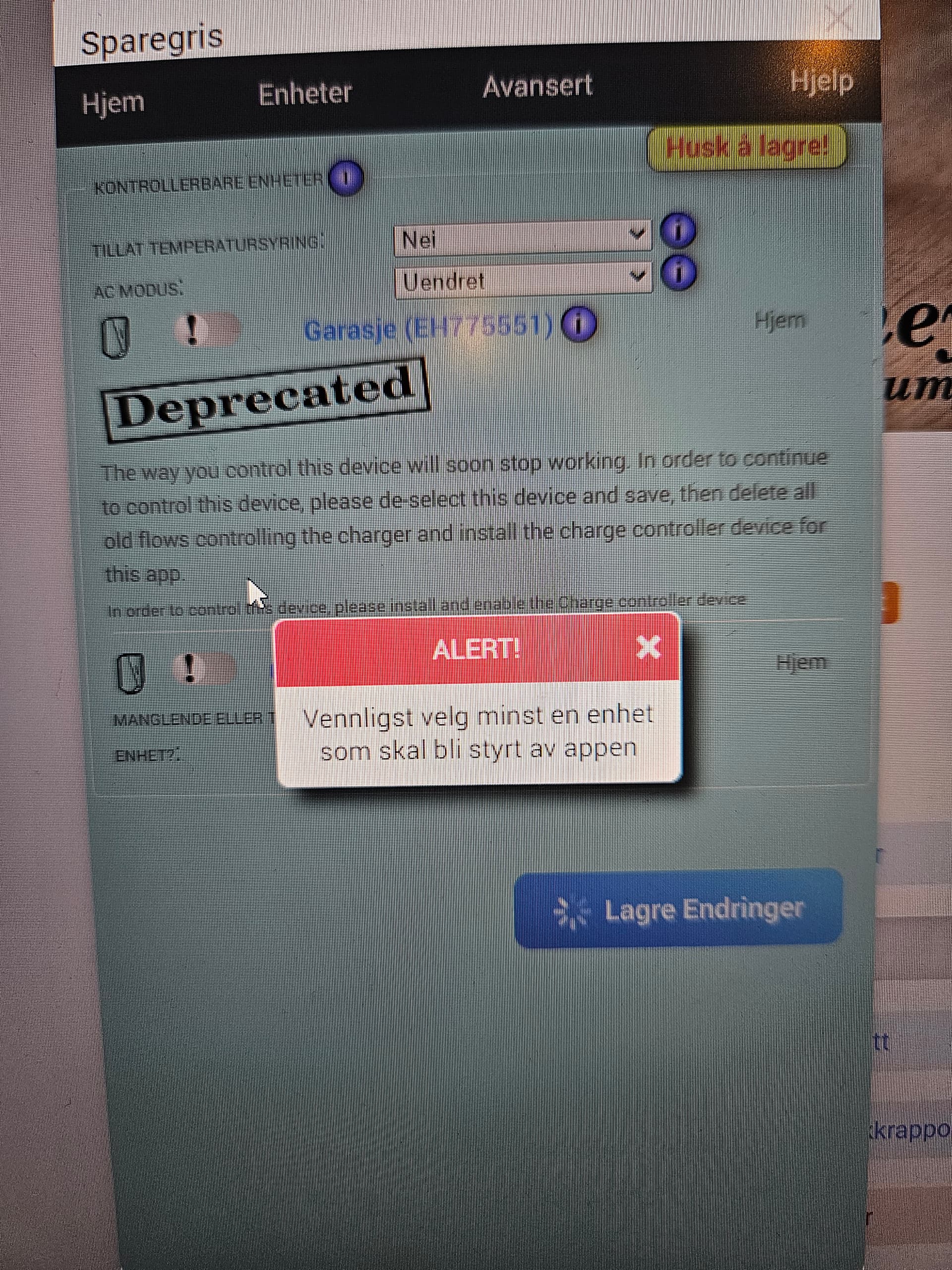

Seen this issue?
Unable to save if not one of the chargers is selected
I deleted the app and re-installed it also
This doesn’t work with the stable version. It will work with the updated test version once I release it.
Then it will not require flows to start, it will always have power available (in the mode Always on is enabled) but it will still be power adjusted.
There is a way to fix this in the stable version already, just go to Settings → Adwanced → Charging and then select override and set the pause current to the lowest current that will still charge your car.
Hmm… its’ not really an issue because you don’t have any units that are controllable. You would need to install the charge controller unit to make it controllable, but I have not published the working version yet, so you’re probably better off with the stable version for now. (Though, I admit that the error message could have been clearer in your case)

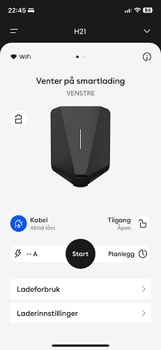

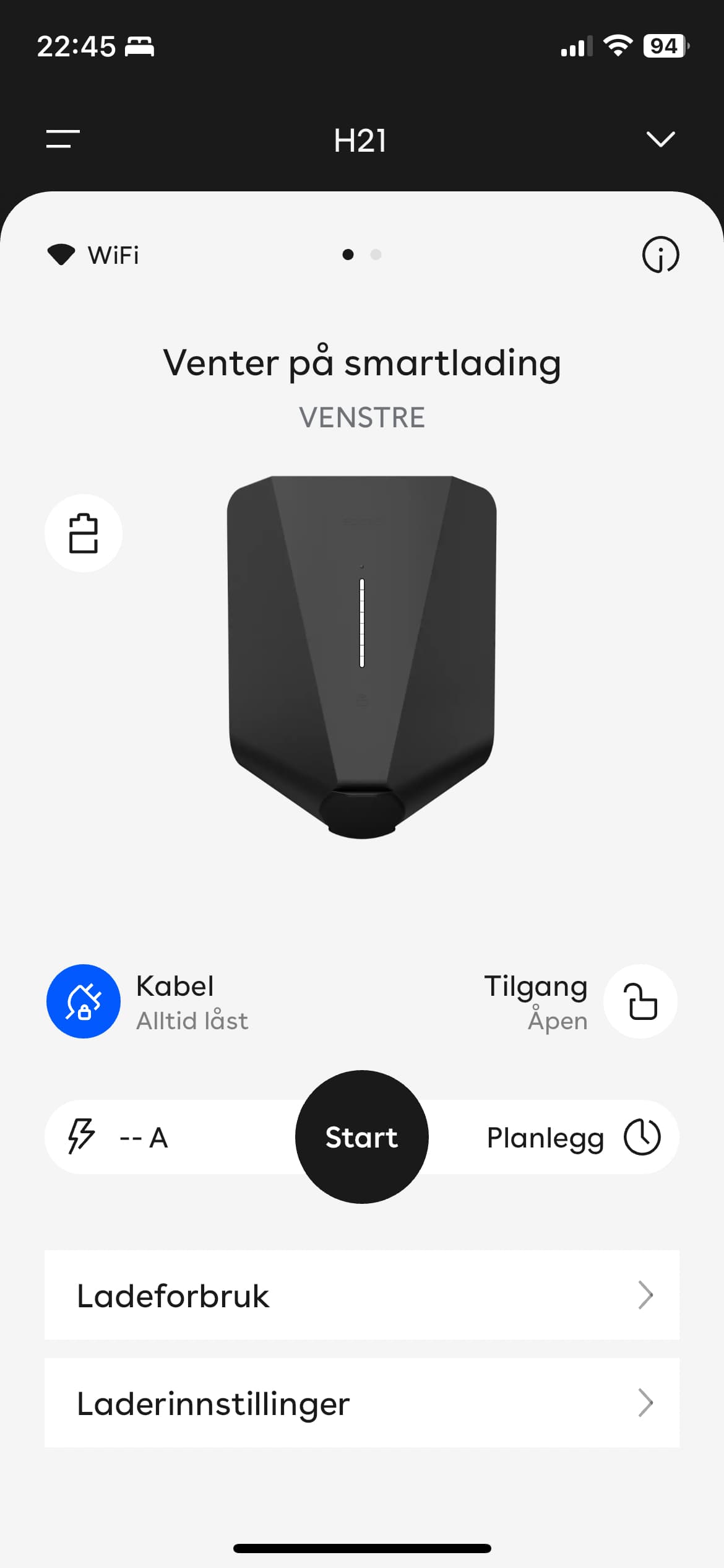

But easee charger app is just switching between smart charging and waiting for the car

I could see it switching in the easee app

I belive i see what’s happening here. The Easee app shows this:
When dynamic circuit current goes to zero.

As you can see there’s no status for “Waiting for smartcharging”. In my experience, with Easee set as operator, Homey primarily report these values:
  • Standby
    No car connected, charger have no errors
  • Paused
    Car is connected, but not enough available current to start charging
  • Charging
    Charge in progress
So “Venter på smartlading” is probably reported as “paused”. You can check this yourself if you fire the mentioned flowcard and check if it returns True.
I think “Car connected” only is possible if you have Tibber chosen as operator. If you have Tibber as operator you might get a different status on “waiting for smartcharging” as well, I haven’t tested. But in my experience, even without a subscription to Tibber, the charger suddenly starts charging because of a signal sent from/through the “Easee operator”. I’m not sure if it can be interpreted as “free smart charging for all”, but it surely is annoying when you disagree with start time. Piggy can possibly stop this as it will detect an ongoing charge outside Piggy’s own schedule. Instead of risking a battle between the Tibber operator and Piggy, I found it more reliable to switch to Easee as operator.
You might possibly get status =“Completed”, I have never seen it, but possibly it’s there for a short time, and then it rolls back to “car connected, no ongoing charge”, which is reported as paused.
