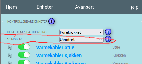

im guessing you ment debug? no troubleshooting options in app
here’s a picture
Ok, I suspect that there is some corrupt state and that when you save an error causes the saving to fail and abort the saving process before everything has been saved.
The setting that is saved right before the mode is the max-power. What happens if you change the max-power to a lower value, saves and exit the settings, then open the settings again. Did the max-power save correctly? Similar, what is saved directly after the mode is the “AC-mode”, does this save properly?
Another option is that if you have disabled popups there is a chance that you can have exited the settings before the settings was saved properly because you didn’t see the feedback that saving was complete?
In the newest test-version (which I see you have installed) the popups have been replaced with a passive feedback, so if that was the case then you should be properly informed when settings is saved now so you know when it’s safe to exit the settings. If so you can try to change the mode again and see if it’s better now?

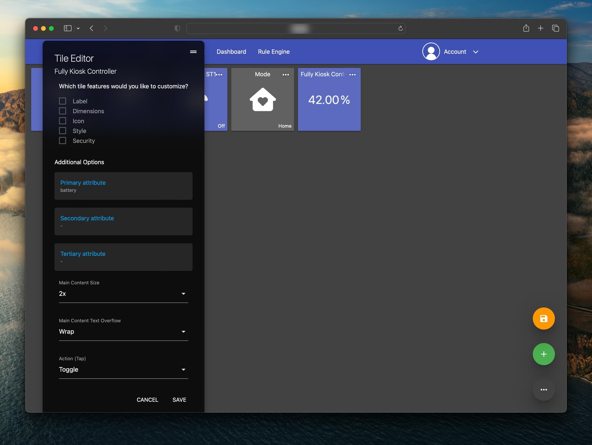

Edit: I should also note that when adding a device to a dashboard, it will get added with a default tile layout based on the reported capabilities. If a thing supports multiple tile layouts, you can change the tile layout as noted here:
The help article also shows a layout called ‘Hero Attribute Tile’ which lets you display any attribute, including custom attributes.
Thanks for helping out Josh!
That is exactly where I would like to show the attribute from the PiggyBank app :slight_smile: But right now the attribute I am requesting is not an option to choose.
These are the options I have to choose from when adding a tile in Sharptools:
And these are the selectable attributes when choosing the ‘Sparegris Innsikt’ tile option:
I would love to have ‘Prispunkt’ (needs translation to English) as one of the attributes.

i can change and save max power without issue, but still not the other tab
Is there any other logs etc i can give you? i have a bit of experience with linux shell/cli, but dont know where to look
ive tested a bit more, everytime i restart the app, i can change it a couple of times, then it uses a LONG time to open the app, or i have to try to open it several times, then it wont save anymore and spits out these errors
Are you referring to AC-mode when you say “the other tab”?
or are you referring to the Operating mode that you already stated did not save correctly?
As for the log, that’s a bit weird, I didn’t expect “OK” to pop up there, I introduced the ‘OK’ in version 0.20.48 but there shouldn’t be any possible way to get it printed in that log… I may have to scratch my head through the weekend to understand what actually happened.
Anyway, so we are clear. The bug you experienced started appearing in 0.20.47? and you have not seen it before that?
