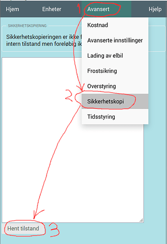

Not sure, but if you send me a complete state dump of the app when you’re in an error-situation I can look at the data and see why you get the behavior you observe. A state dump can be made as follows:
you have to manually copy the state from the window and into an e-mail.
EDIT: After having had a look at the state dump I see that the issue is that the desired temperature is lower than the lowest wanted temperature (frostGuard) and as such the temperature is clamped to one degree above the frostguard. (the frostGuard temperature is only used for emulating turning the device off, so it’s always above that when it’s considered “on”)
