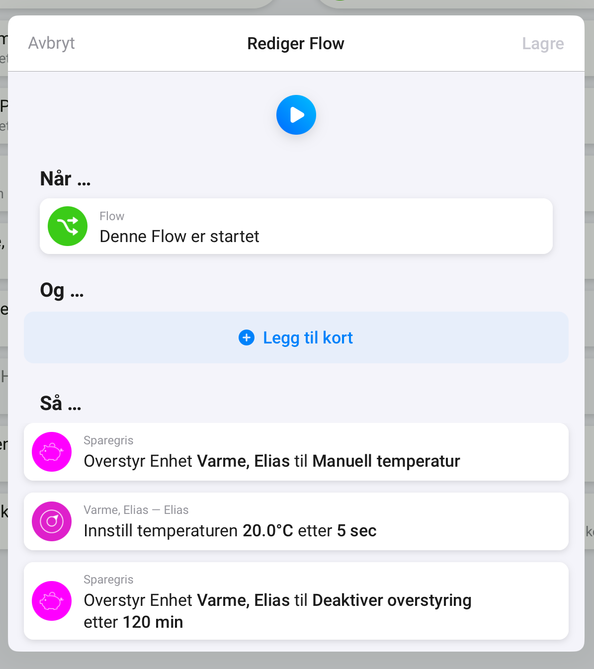

The wify has requested(demanded) the ability to manually controll the heat pumps if she want to without it being reverted by Sparegris (don’t ask why, it’s easier to just accept it :face_exhaling:).
So i’ve set up an AVD for each pump with a list (much like the Sensibo app) that gives 5 options:
Automatic, Heating, Cooling, Manual, Off.
And then I’ve adapted the Sparegris controll flow(s) accordingly with overrides etc.
BUT: When it comes to the “Manual” mode, i only have the option to either use “Styrt” or “Manuell temperatur”. I would love to have a fully manual option :no_mouth: So she could adjust anything she wants without Sparegris overriding it.
And yes i absolutely understand this will throw off any sort of smart features, but hey what to do :face_exhaling: (i will make a flow that switch it over to the auto/heating or cooling at 3:00 every night so she won’t have full controll lol)

Yeah that would work, but is it possible to set that with a flow? AND per unit? She usually just want to manually fudge with the one in the 1st floor living room, none of the other ones. So putting all AC devices in “Uendret” mode just to gain manual controll over one device ain’t ideal :see_no_evil_monkey:
Edit:
It looks like it’s an bug in the test version btw, if you try to deploy a new “Så->Overstyr enthet til” you aren’t able to choose an unit, it returns a blank list in android app/simple flow. Or an error message if you’re trying to make an advanced flow.

I’m seeing no controllable devices when trying to make a new flow to override a few devices.
I have an old flow where this is done, and it still works…
There are a lot of controllable devices in piggybank, so I don’t understand what’s going on…
I’ve tried rebooting Homey, and disabling/re-enabling devices in the piggybank controllable devices list, but nothing seems to work.
Any obvious fix I’m not seeing?
Edit: same bug reported by Exerqtor 10 days ago. Didn’t find it by searching because it didn’t contain exact wording :sweat_smile:
