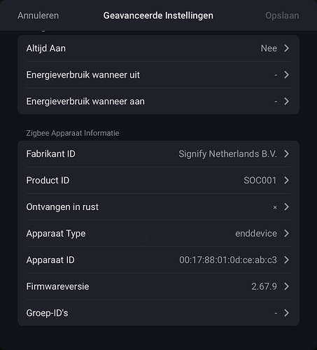

Seems there is opened issue for this sensor already since 10/2023 - New Philips device: Door Secure Sensors. · Issue #504 · JohanBendz/com.philips.hue.zigbee · GitHub
