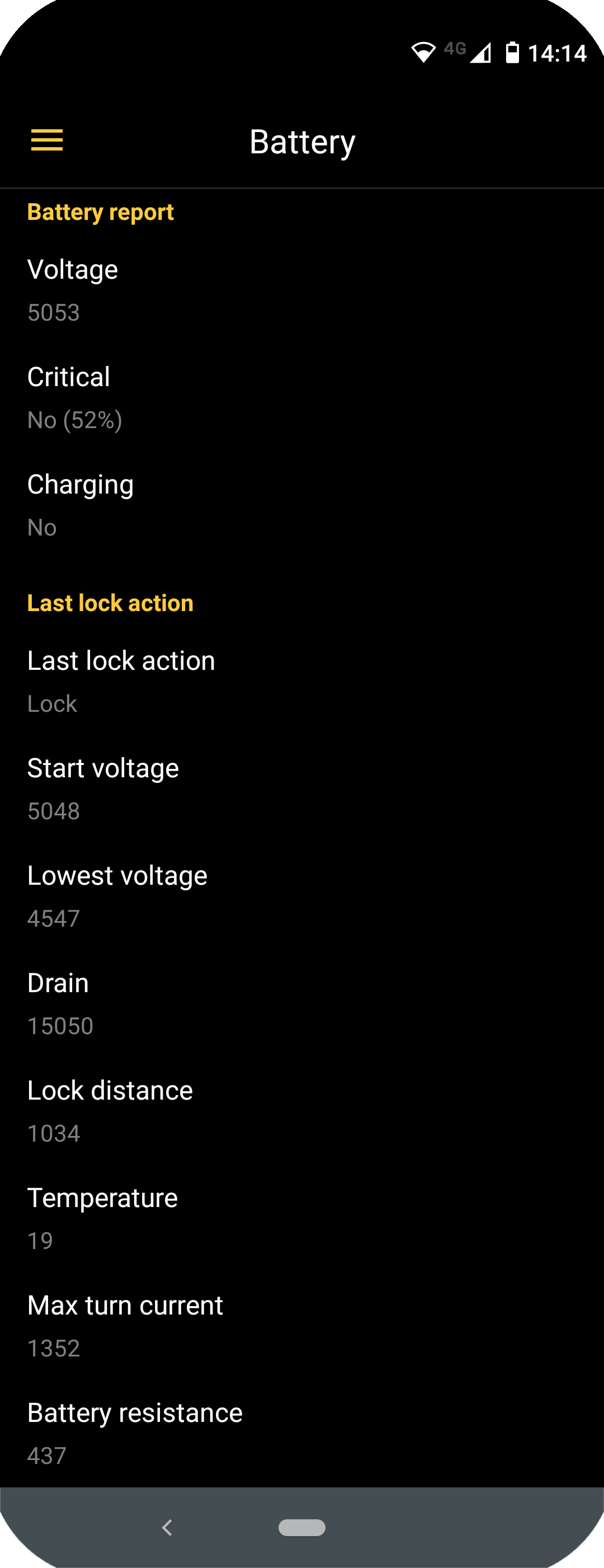

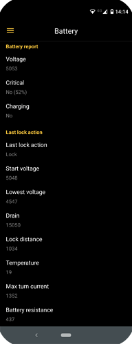

I don’t know but I have to recharge my batteries more often than before, normally every 3 months now every 1,5 month that is an use decrease of battery live.
I understand that now we are at home the whole day it takes more battery live but twice as much ?
Hello @ChrisBoer,
The Nuki apps for Homey (Nuki Direct and Nuki app by Athom) communicate only with the Bridges, so they cannot drain the battery.
Maybe your battery drain is caused by other reason, lower temperature, lack of mechanical lubrication, …
The Nuki app for smartphone reports very detailed information about the battery usage for lock/unlock operations.
There you can check if the consumption for an operation is too high and/or if a proper cleaning//lubrication of the mechanical parts may decrease the load on the SmartLock motor.
