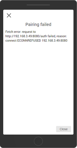

A suggestion: When Homey is in the error condition (after a restart), you can try a pairing procedure. The pairing procedure causes Nuki Direct to send some HTTP requests to the selected Nuki Bridge and to print a detailed report about the received responses. This may help the analysis.
Where can I find the detailed report about the received responses?
In the pairing procedure I do expect a pairing failure similar to the following:

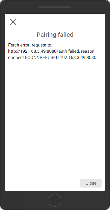

Hello @Piero_F,
This night the connection to the Nuki Bridge was interrupted again. The smartlock and the opener have a red exclamation mark.
This is the screenshot when I try to pair the Smartlock:

Hello @DirkG,
Sorry but as software developer of Nuki Direct I see neither bugs in the app nor improvement possibility in the code of the app for avoiding the condition you clearly explained.
I tried to reproduce your condition.
I disconnected my Bridge from my WLAN (by deleting the Bridge from the router configuration). I waited for a while. Nuki Direct reported the devices as unavailable (as of Nuki Direct v3.0.0 the app has the capability to mark the devices as unavailable, if the bridge is not reachable by Homey in the WLAN) but still the Nuki app for smartphone wrongly reported the connection between the Nuki Bridge and the Nuki servers, as you pointed out.
I think this is a minor error of the Nuki app for smartphone…
In this condition I’m still able to send commands from the Nuki app for smartphone to the Smart Lock through Bluetooth.

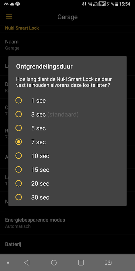

@Piero_F I have installed your app and it is working great.
I am missing some functionality though.
It is about the unlock and hold door open function in nuki.
In the Nuki app you can set it to hold it for x seconds *( 3 is default).
I changed it to a higher value and from the nuki app it works.
Although the Athom app has this option, it does not work, and support claims it is not implemented yet?
Strange because you can select it.
Are you able to include such a function ?
Hello @Rens_Hoekema,
Thank you for appreciating Nuki Direct.
Reading the public Nuki Developer Documents I understand that:
The Nuki Web API used by Homey app by Athom allows selecting how long should the Nuki Smart Lock hold the latch when opening the door. Thus, Nuki app by Athom may implement this setting.
The Nuki Bridge HTTP API used by Nuki Direct does not allow it (yet). In Nuki Direct there is a specific a specific slider for opening the door but it holds the latch for the time interval you previously selected in the Nuki app for smartphone.
Therefore, the answer to your question is: unfortunately Nuki Direct is not able to set the unlatch time interval (yet) because the Nuki Bridge HTTP API does not provide this setting to the developers.
Thank you for your reply, you say “not yet”, do you have any idea if this will be anytime soon ?
I wrote “not yet” because in the past some capabilities first have been added to Nuki Web API and then they have been added to Nuki Bridge HTTP API (for example: door sensor events) or vice versa. So, I can argue that in the future the unlatch time interval setting will be added to Nuki Bridge HTTP API as well. However, Nuki does not disclose in advance its development plans…
Thank you @Piero_F, I hope you can ask the nuki team to add support soon.
