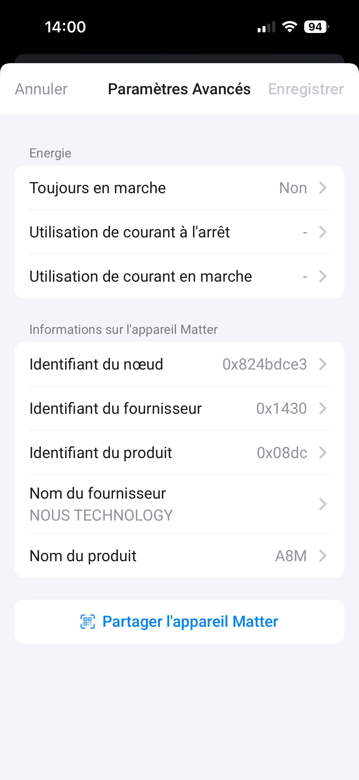

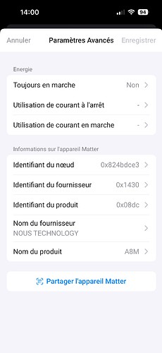

Hello ! Can i ask you to add the A8M ? I pretty sure it work like the A1Z (power socket with power measure too), but it’s not recognized when i added it in Homey.
I’d love to make a PR on your repo, but i don’t find it btw.
Here a screenshot of the device. (I don’t get why it’s in hex)
EDIT: I’m totally wrong, i should be sleepy, but it’s a matter device, and i see that you don’t have any matter device yet in the app. Do you think you can work with/for it ? If you can’t, i’m ok to help to develop the Matter integration in your app. I prefer to contribute than doing my own app on my side.
Hi winnieoursbrun,
Effectively, Nous App only support Nous Zigbee devices.
Matter device should work well with Homey native driver.
Have you tried this ?
Regards,
SoPhos
Hi @SergeP, yes it work normally as a generic switch, but i don’t have the power usage :sob:
Hi winnieoursbrun,
I suggest you to open a ticket at Athom for that problem, it’s not normal.
Power usage is part of such a power device and Matter knows how to handle it.
They must just implement it in Homey Matter driver.
Regards,
SoPhos
