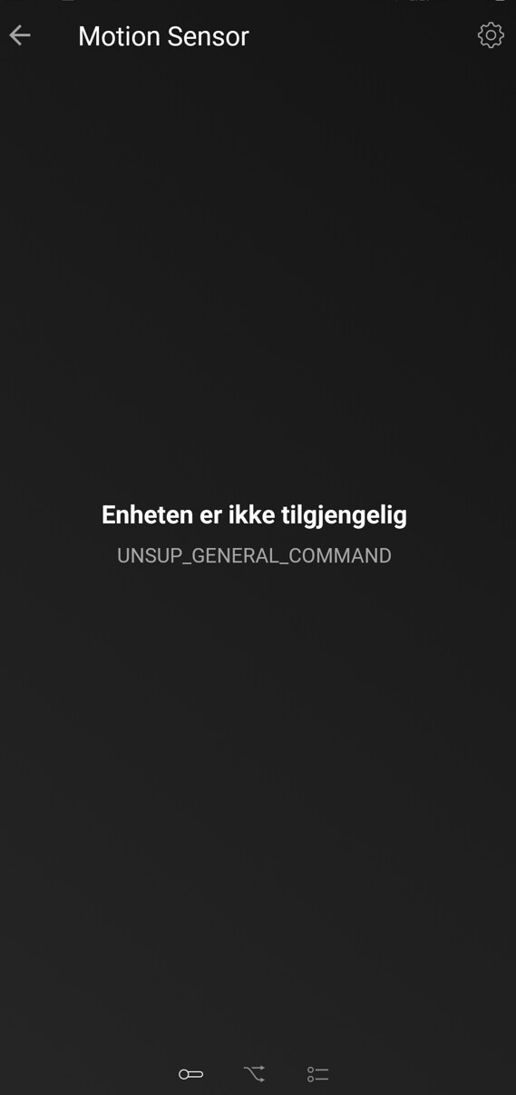

I have now tested the Tuya Zigbee Test app.
When I am adding the Nedis smart PIR Zigbee to this app, it looks like this:
This is how we want it to be, but after 5 seconds it looks like this:
These are the properties:
So it seems like it’s a match for 5 seconds, and then it’s not working ;/

I saw it was possible to add Zigbee devices through Homey itself.
Doing this with the sensor in the same room at the Homey makes no difference. So the distance is not a problem.
Also, it recognizes the device as soon as I put it in pairing mode, but it still says it is unsupported.
I was able to interview it aswell, result:
What does this tell me?
