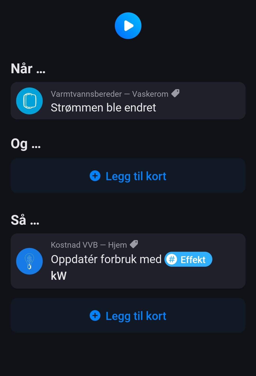

While waiting for a stable Strømregning with calculation of Subsidy, I created the following flows. My cumulative number matches that reported by grid provider Elvia. I will update and try Strømregning’s subsidy calculation soon.
