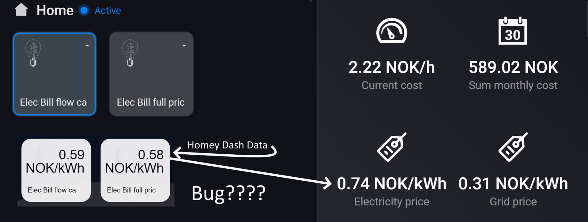

Bug???
In the configuration:
Calculate daily cost/consumption: Excl/incl Tax Does not seem to do anything.
Data in the app does not match the data sent to Homey Dash. Seems like data sent to the dash is minus tax?
El. Cost sent to the app via Flow, should it be with tax or not? I have tried many things but can’t get the data to match manual calculations
Seems like the field showing Electricity Price, is showing without Tax even though Tax is in the formula. PRICE_NORDPOOL * 1.25 + 0.0299 , This seems to crash with From Flow where the same calculation from a flow will show in that field with Tax.
