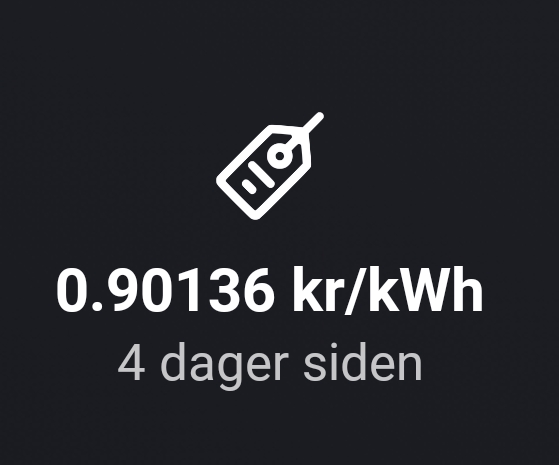

Hi
Electricity price seems to have not been updated in 4 days.
