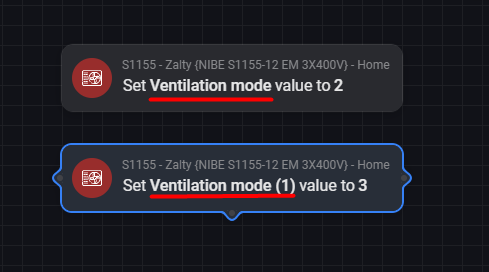

You had a very interesting case in which two datapoints (the two ventilations systems) got the same name. I personally think MyUplink should not have let this happen, but - they did, so we need to handle it. I assume it happens due to the fact you have external systems for ventilation, and therefore they were provided with the same name
I therefore added a small fix to the app which handles name collisions on datapoint names, and now you can control and monitor your fans.
Here’s the instructions on what needs to be done:
  1. Make sure you got the latest version updated: version 2.0.15
  2. Remove the heatpump you added on previous version, and add it again (so the names will be refreshed). Your device has more than 850 datapoints, so it takes some time :slight_smile:
  3. Once the device is added, click on the device-settings gear icon:
  4. Take all the content of the “Datapoint Names” textarea, and copy it to a text editor you you can see the names clearly:
On the text editor, find the “Ventilation Mode” datapoint. You will see there are two:
Ventilation mode and Ventilation mode (1) - this is my fix (in previous version, there was only one)
  1. Go back to the device settings, and copy “Ventilation mode” and “Ventilation mode (1)” from the text editor to two of your datapoints (any two will be good):
click the “Save” button
  1. You can now see the status of the two ventilation systems on the capability pane:
  2. You can now add “Set Datapoint Value” flowcards (THEN flowcards) in order to set the ventilation mode of the two sub-devices:
Once you set the values of the ventilation systems, it will take the capability pane of the app up to 1 minute to refresh.
I hope this solves the problem, let me know if any issue arise.

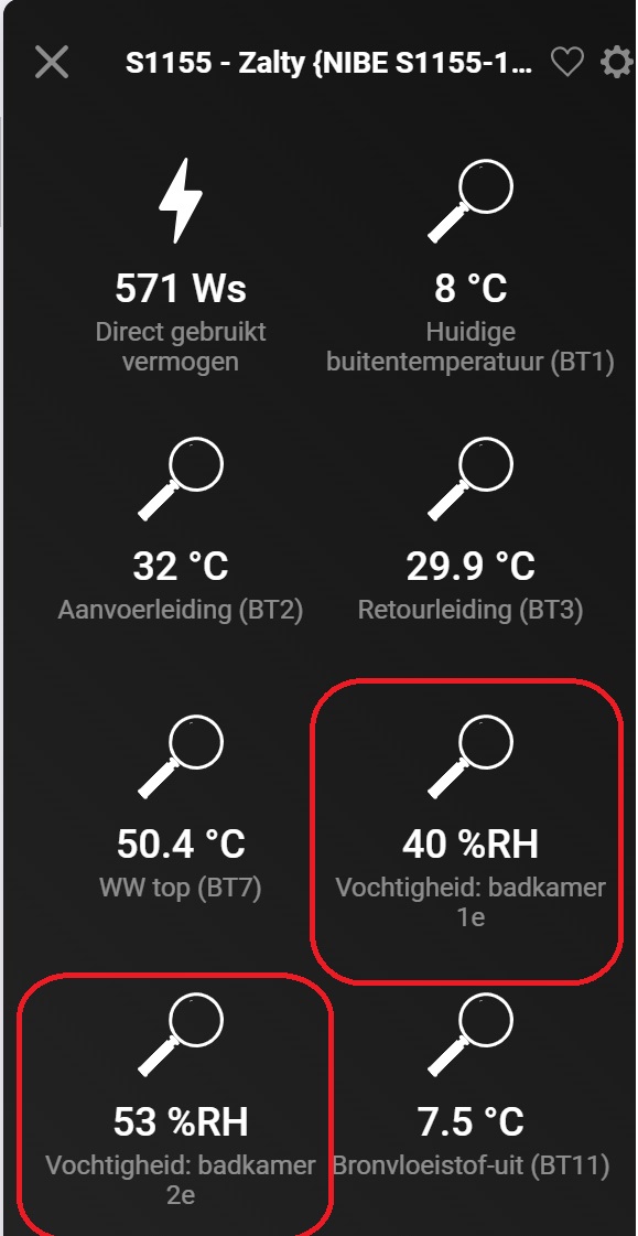

Hi Gal, Controlling the two ventilations works really great. Thank you very much for that.
I only have one more request regarding measuring the humidity. I can read this data point (see red lines in the photo), but I cannot start a flow based on this data and, for example, turn up the ventilation speed.
Is it possible that you add an “If” flow card in which you can, for example, set the flow to start when the value of a data point exceeds (or falls below) a certain value?
regards
Wouter

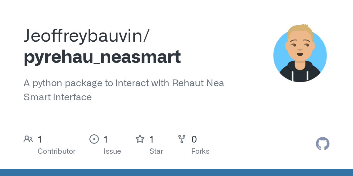

Hi Gal,
Another question. My Nibe heat pump is controlled by various Rehau smart 2.0 thermostats. These Rehau thermostats are also controlled by an app. I think there is also an “kind of” API you can use.
Would you like to make a Homey app for this too? There is currently nothing for the Homey.
greeting
Wouter
Ah, this helped me a lot! Thanks for now!
The Rehau Thermostat’s API seems rather simple, but I am pretty much occupied now with implementing a different app (Alsavo Heatpump for swimming pools).
If possible, please ping me in a month from today and I will try to implement it.
