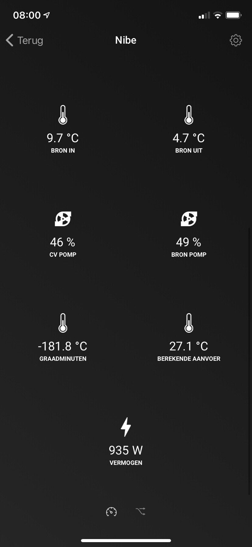

I’m working on an app for my Nibe S-Serie (S1155-6PC) to read out values like temperatures, brine temperatures, pump statusses, etc… It’s not connecting through MyUplink API, but through modbus (over TCP), which is built-in in the S-Series.
Things I would like to add, but not yet done, is the RMU S40 as a device.
At this stage no flows are created for the app, but if there is good use case to do so, I’ll try to add that too.
Example:
Anyone interested to have such an app? If so, I have to polish it a bit, add some additional stuff.

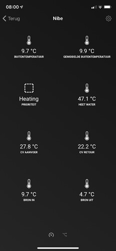

This is what I have sofar:
Still some things needs to be better coded.
