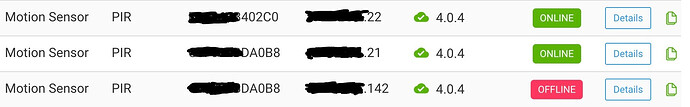

Here is a screenshot from MyStrom Troubleshooting tool:
… you can see the ‘old’ IP address is still there and shown as ‘offline’
After starting the app, discovery notice messages from the myStrom devices are displayed in the simpleLog. Is the pir included there?
BDW: The sensor with the Mac-Adr: DA0B8 is present twice, so one way or another something cannot be right.
Your question - PIR included: no
Your statement - DA0B8 is there twice: that’s my point. → do you know, how to the the legacy entry out of the list?
If you don’t have an entry, the sensor won’t connect to the app either…
