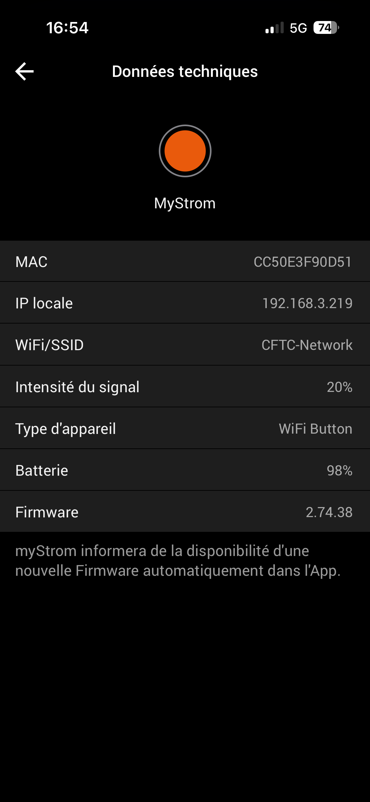

I just installed my Homey Pro 2023 and I can’t pair my WIFI button (PQWBB1), the pairing ends with “no device detected” whereas in the MyStrom app everything is fine.
Can you help please ?
Read please..:woozy_face:..
I did read that, thank you :slight_smile:
I understood that I had to go through the MyStrom app to add/pair the button, which I did correctly again, however how do I link acec Homey in order to see the button as a device? This is what I don’t understand.

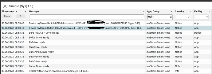

  • Install the SimpleLog app
  • Then restart the myStrom app.

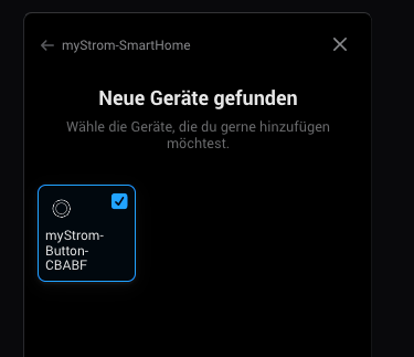

  • Now you should see the following entries in SimpleLog.
  • If the button (type: 104) does not respond, try to connect the button to the power adapter and press the button at the same time, this worked for me.
  • Now it should work
  • If not, then you have a problem with your LAN.

Thanks for your time, your answer.
I installed the plugin to get the logs, restarted the MyStrom app and Homey Pro 2023.
The button was plugged in and I pressed it every 3/4 seconds.
After these operations, the button is still not detected …
Here are the logs:

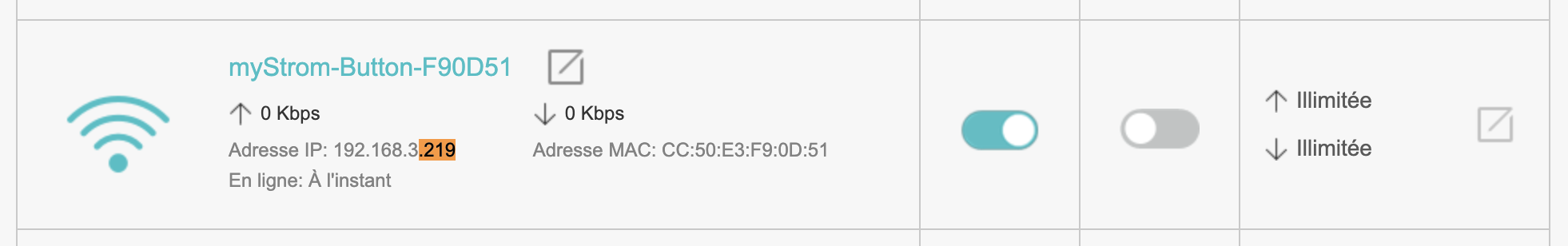

I then checked the button’s network information, and it was indeed connected and detected by my router:

The button is indeed present in the MyStrom app (see my second capture in my previous reply), connected to my router and plugged in via USB, everything is ok at that point.
It’s your app in homey that doesn’t detect, doesn’t log anything about this button.
NOPE, on the other devices it works and the code is a standard library neither from me nor homey

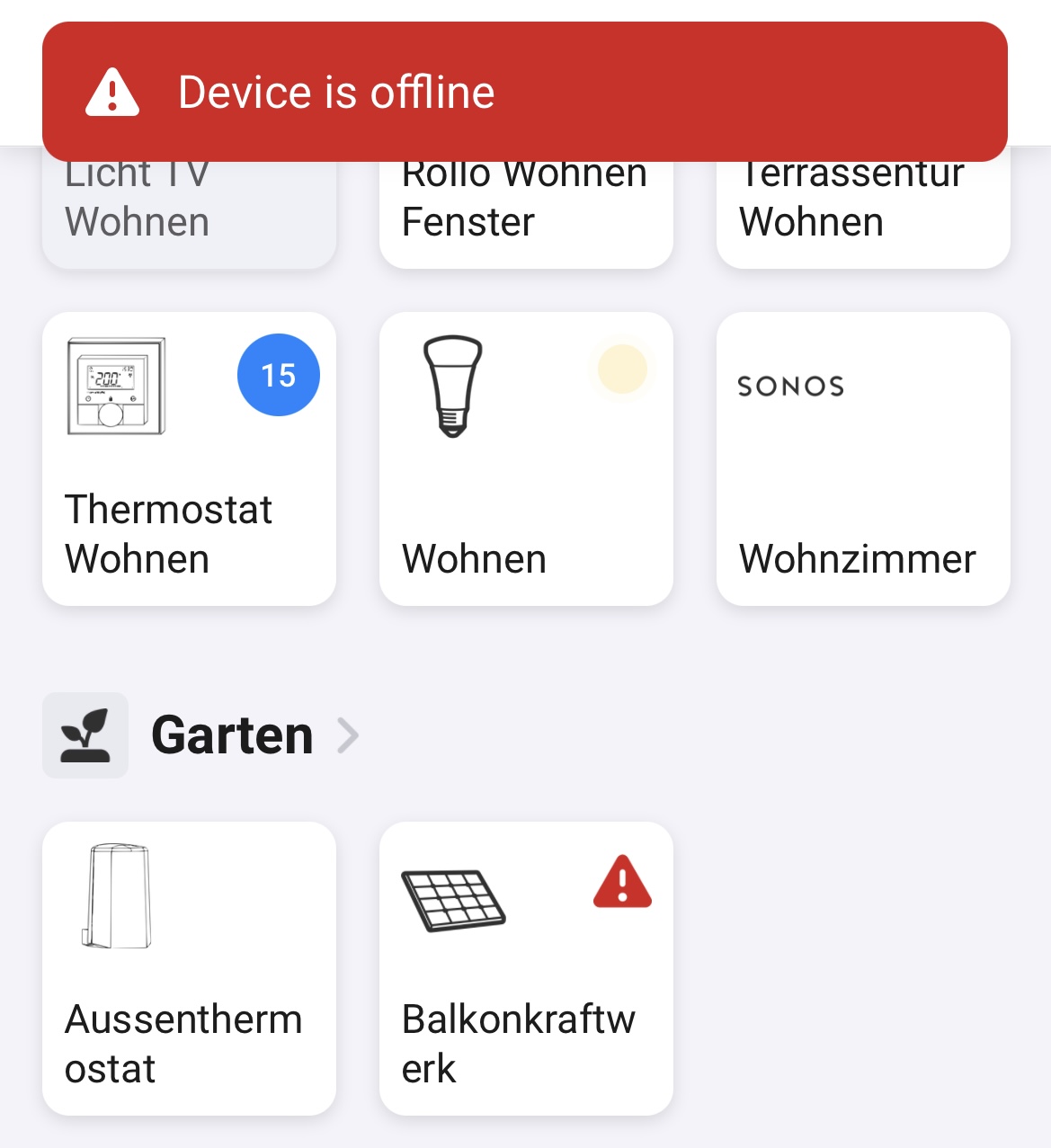

Hello Chris,
my Wifi Switch (EU) regularly goes offline in the Homey app.
If I disconnect the switches completely and reconnect them, they work for a few hours, then I get the red exclamation mark again, device offline.
In the Mystrom app directly, the switches are displayed correctly and work.
The switch that I have set to solar production, on which my balcony power plant is connected, goes completely off. It permanently shows Device offline.
The switch for the coffee machine is offline for two or three hours, then briefly back online and gone again.
Mystrom WiFi Switch (EU) Firmware 4.0.7
Mystrom App V6.0.2 (iOS)
Homey Pro (Early 2023) V10.0.0-rc.133
Homey App V7.0.3.1209
Homey connected via LAN
Maybe you have an idea, can you help me…?
Thank you
Best regards
Marco
What does the exclamation mark (hover) or the device itself say ? Because without error message an analysis is difficult…
When I click on the exclamation mark, the message “Device is offline” appears.
As I said, in the Mystrom app itself the device is available, provides current values and I can switch it. Also the recording works.
