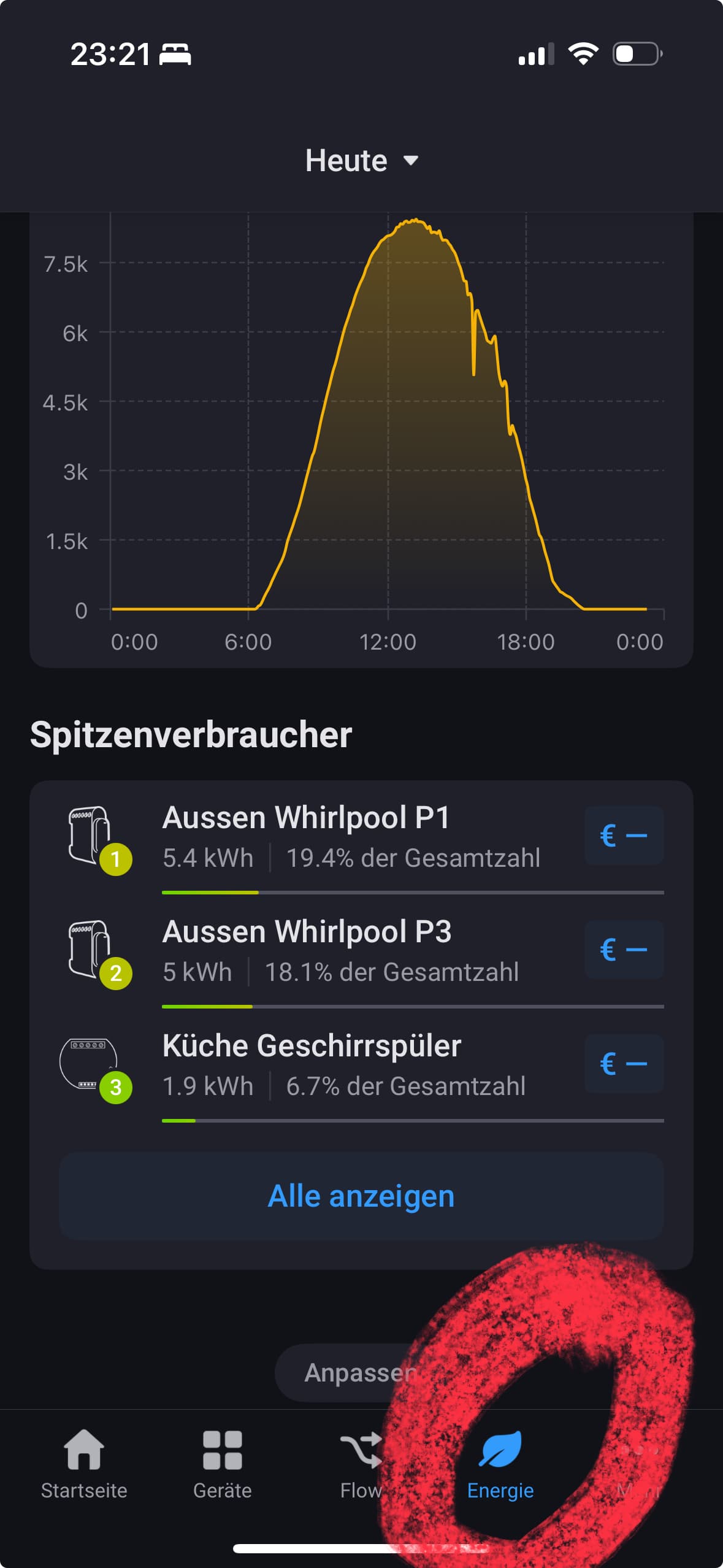

@ChrisG would it be possible to add an “Energy” value for the myStrom (v1/v2) Switches? Because, without Energy, the device doesn’t show up in the new Homey Energy Tab - all my Shelly Devices as well as the Solar Devices etc are visible, except the MyStrom adapters. And in my opinion the new Energy Tab gives a good overview. I really miss the myStrom adapters there…

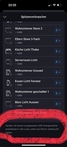

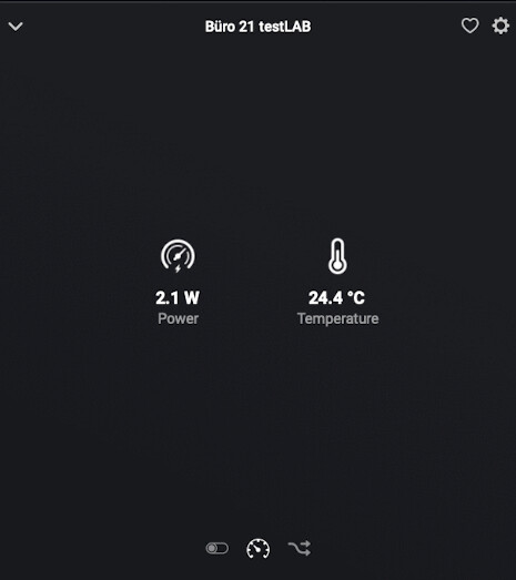

True, the Power (Leistung in Watt) is there, but I’m referring to the new “Energy” Tab in Homey:
There it is required to have the Energy in kWh. So without the Energy value (kWh) the Energy Tab shows no myStrom adapter…

Good point, a bit sad that it isn’t supported directly in the app (the v2 adapter itself does it support out of the box…). With “Power By the Hour” I need to create an additional device, of course this would work.
v1.4.1 is now live :
  • New Switch Ex device added.
  • Switch Energy meter added (Only for Switch v2 & EU & Ex)
