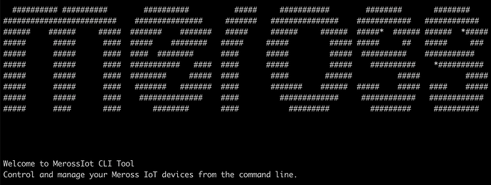

Did some testing over the weekend to add support for more devices, both via cloud and locally. I don’t really feel like waiting for Meross to roll out OAuth support across their entire lineup, that might take a while.
So, I took a look at the Meross IoT library (the same one used by Home Assistant) and basically converted it to work on Homey. Through this library, almost every Meross device should be supported. By default, it uses MQTT over the cloud, but if the device is detected on the local network you can switch to full local control.
Authentication currently works through a simple credentials login screen, which then lists the devices available for pairing. I’m planning to add OAuth support later, so devices can automatically switch over once it’s available.
I’ve just laid the groundwork this weekend. I am still wrapping up my Whisker app for Homey before diving deeper into this, but hoping to have it all working soon!
Quick update from my side. I’ve been working on porting the Meross IoT Library to Node.js. I used the meross-cloud NPM package as a starting point and updated it to behave more like the Python implementation.
I’m currently resolving the last bugs, after which I’ll publish it as an NPM package for general use. Once that’s done, I can start adding support for more Meross devices to the official Meross app for Homey.

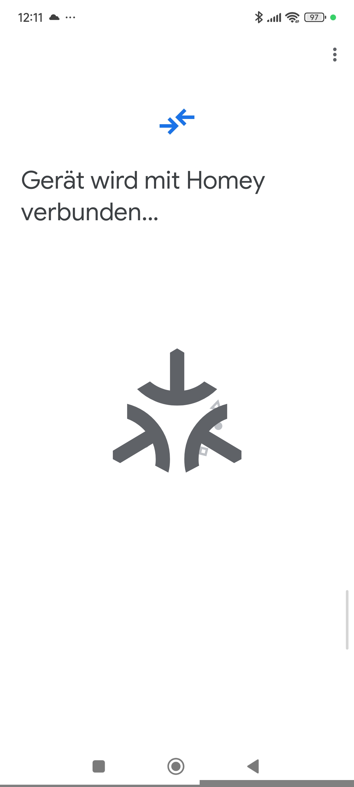

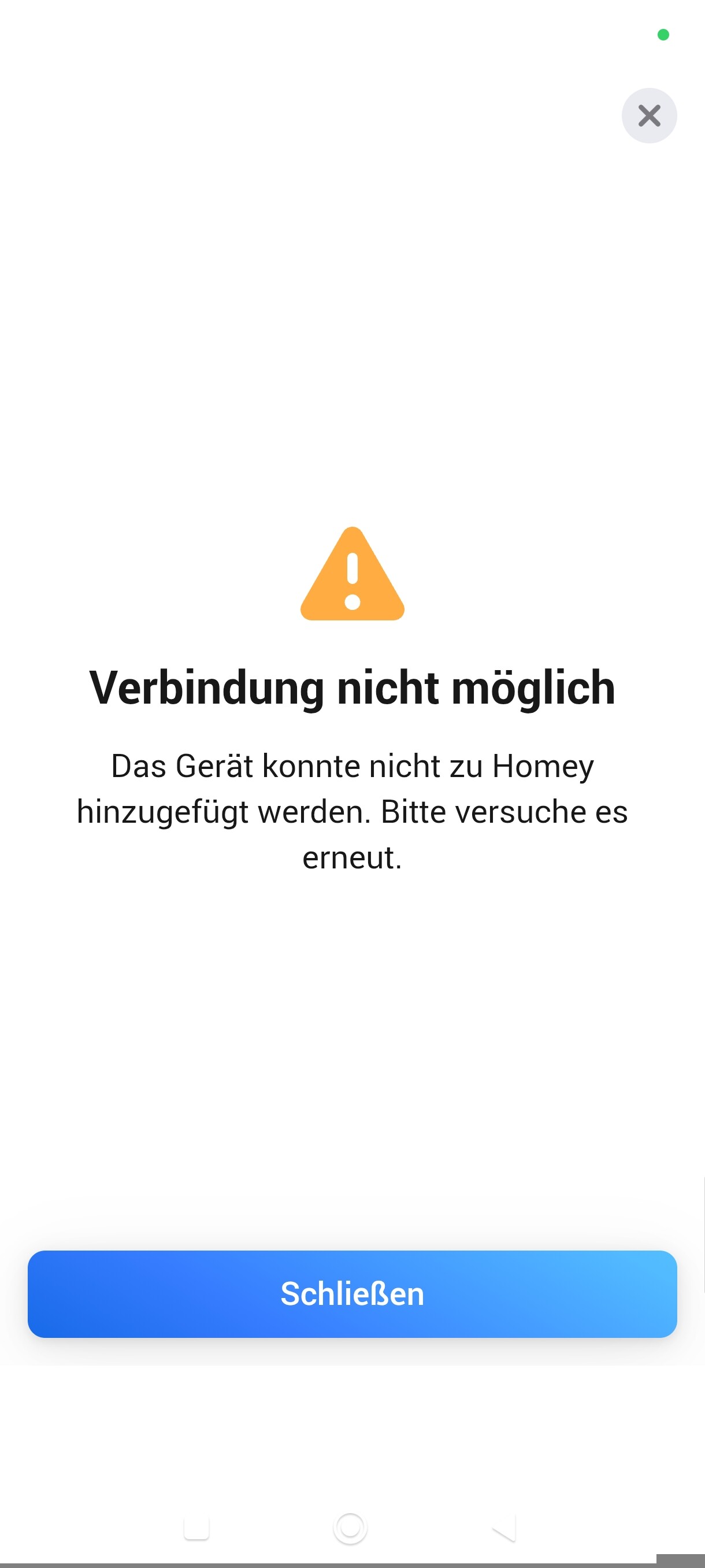

It is not possible to connect the MS605, regardless of the method, neither directly with Homey nor via the Meros app with Matter Code sharing.

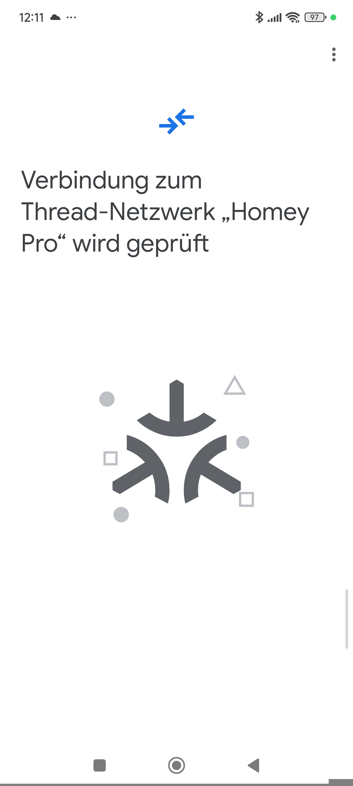

How far is the device from your Homey when you are trying to pair it? Since it’s using Matter over Thread you need to have decent Thread coverage.
I even set it to Homey Pro during pairing, and I have two more Homey Bridges in the house.
You’re not connecting the device via Homey Pro, but instead using your mobile phone with Google’s Matter setup. Via this route it will use the preferred Thread network of your mobile phone. Which Homey version (Pro or SHS?) are you using?
Also, Homey Bridge does not have a built-in Thread radio and therefore does not extend the Thread network.

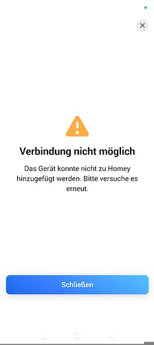

I’m using Homey Pro with Thread, and it’s worked with all my previous Matter devices, but it doesn’t work with this one. I even have two MS506 devices. There are two ways to connect to Matter via Homey Pro on my phone, and one via Android, but neither works. I also tested it with an iPad, and the connection is the same: it aborts as soon as the device information starts loading. The firmware on both Meross devices is up to date.
I have the same problem with the MS605; I can’t add it to Homey Pro or my self-hosted server. It’s simply not possible. All devices have the latest firmware. The problem occurs via both the web interface and the app.
