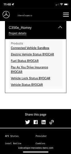

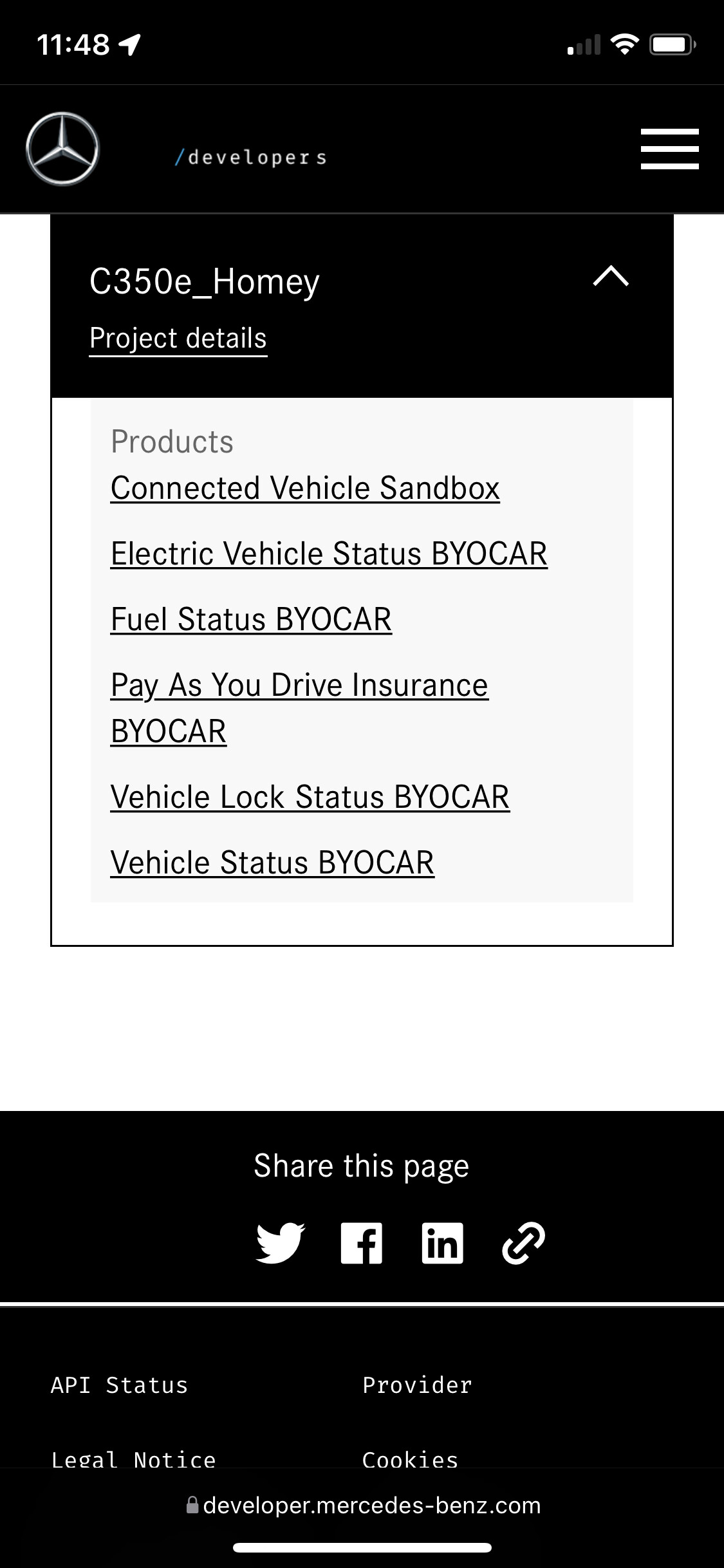

Hi Adrian,
Hereby a screenshot of the products i configured:
Could you try removing the Sandboxed one?
I wonder if that is causing a permission issue.
FWIW, the Home Assistant integration started to have a similar issue a few days ago: Mercedes Me Component - #1021 by ReneNulschDE - Custom Components - Home Assistant Community
The developer was able to fix it.

If i remove the sandbox one, i get an authorization malformed notification, can’t add the car to Homey.
