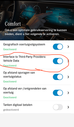

Hi Adrian,
Found out what the issue was:
“Interface to third party providers” need to be enabled in the mercedes.me app.
Works now :slight_smile:
Greetings Joost
Good find. I think I set that option so long ago I had forgotten all about it.

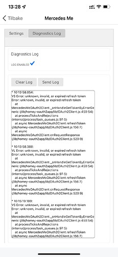

The app did not retrieve any data, sent you the log again.
Maybe things need to be enabled in a specific order? I deleted and recreated the project, now i’m stuck with an empty log and the following error:
Okay, uninstalled the app in Homey and reinstall did the trick. Don’t see any data yet, going to take the car for a spin, maybe the car didn’t sent any data to the servers yet.
Keep you posted :wink:
I finally got around to looking at your log, sorry it took me so long.
Basically it is saying that the server is not supplying any data for any of the features.
Hopefully once the car starts to send data now the options are enabled it will start to filter through to Homey.
