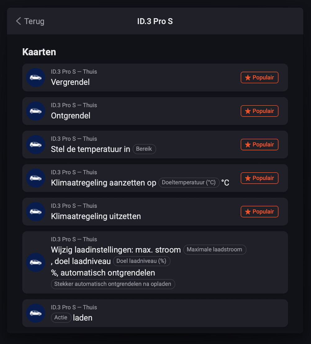

Released today (changes):
  • Then flow card that allow you to start/stop charging
  • Then flow card to set the target charging level, charging speed and auto unplug cable
  • Improved hints when logging in fails
Now in testing (changes), download and install from here:
  • Setting the climatisation to a given temperature
  • Starting and stopping climatisation
  • Improved fetching capabilities from the Volkswagen API to prevent spamming
Note that these are separate actions, so setting the target temperature won’t turn on the heating. You must add two flow cards to set the temperature and then start the heating. In the next update, I’ll combine these actions into improved then flow cards as well as allowing you to set for how long the climatisation should last. Currently, it defaults to 30 minutes, but you may call the stop then flow card earlier if you like.
Let me know if you find any issues! :waving_hand:

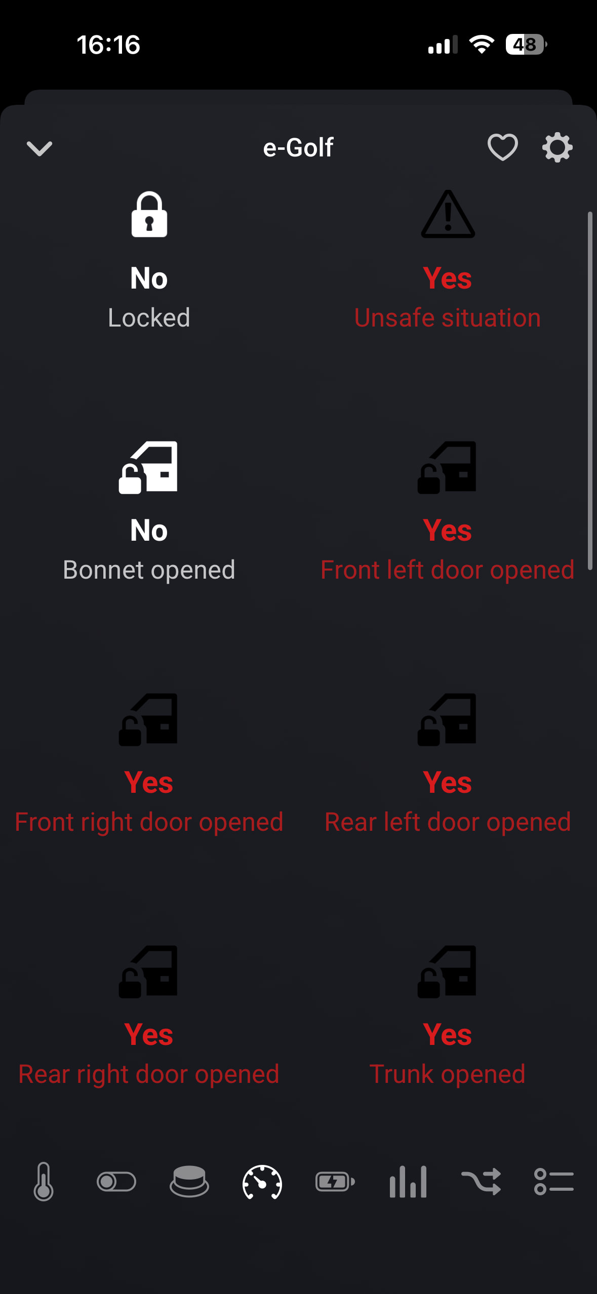

Hello!
Testing with our old VW e-Golf, seems to work.
Except while driving: all doors is reported open and an “unsafe situation” is reported.
What could cause this?
Thanks!

This is a tough one, because I cannot really debug and drive at the same time… There are two possibilities:
  • The vehicle doesn’t update the data when you’re driving, meaning it reports the last known state which is open doors just before you left.
  • The vehicle doesn’t automatically lock the doors when you drive away, meaning there’s an ‘unsafe’ situation.
Unfortunately, I don’t think there’s something I can do about this right now. I checked the Volkwagen API response for you, but I don’t see any property that indicates if you’re currently driving or not (probably because you’re not support to use the Volkswagen App while driving). This means that I cannot do anything except for what I’m currently doing, which is just reporting the access status that the Volkswagen API gives me.
If you’re using this in a flow, I’d recommend to combine it with the distance from home parameter. :thinking:
Thank you for your response and let me start by saying that this is an excellent app—I truly appreciate the work that has gone into it.
Once the car is parked, the data remains unchanged until the next scheduled update. Since I have chosen to let the updates occur at 10-minute intervals, there can be a delay of up to 10 minutes before the information is refreshed. During this period, the system may display a message indicating that a hazardous situation has occurred.
If the car were in motion, this could momentarily give the impression that an accident had taken place. While this is not a significant issue at all as long as users are aware of it, I thought it might be helpful to bring it to your attention.
I will check if the autolocking of the doors is still active the next time I drive the car, it was active the last time I used the car.
Again, no big issue at all.

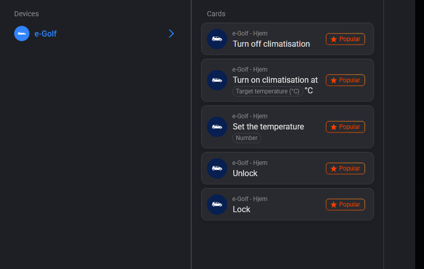

Fidling around to learn what the app can do.
I can’t find a function to turn charging on or off—maybe this doesn’t work on an older e-Golf?
Thanks!
That’s so strange. Someone else sent me an e-mail about that as well. That action-card is linked to the measure_charging_power capability (or Charging power in the app). Do you see this sensor in your device? Unfortunately, I don’t have logs from the responses of the Volkswagen API for your device. If you know how to log these, please send them to me so I can debug this value. The conclusion is that it only shows this flow card when capabilities.charging?.chargingStatus.value.chargePower_kW is a valid value.
Many thanks for your reply.
I can’t see the measure_charging_power capability or Charging powerunder devices.
I guess this fuctionality is not possible with the e-Golf.
Unfortunately, I don’t know how to log the responses from the API.
Cheers!
