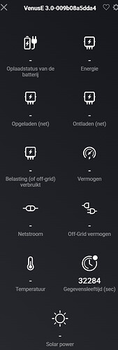

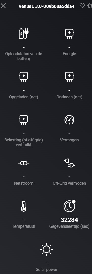

No i havent i saw another one called Passive and then how long in Seconds. SO the one you suggest is better.
But my battery doesnt give me any info.
I did the following: re-add the batteries, but use the cloud function this time! That way, you will see the reasonably current status. Next, set the ‘Enable (periodic polling)’ option to no.
Edit:
The only drawback is that the batteries are duplicated, but you are now able to create flows! And the commands are received successfully.
I am working with the test version, The app is receiving irregular the Energy (kWh) and Temperature values (via the Bat.GetStatus API request?). A timer is incremented every 5 seconds. No other values are shown in the APP. Listening the 30000 port I noticed a large number of API Bat.GetStatus requests from the APP not answered by the battery.

I tried it and after that it’s still says it’s on the old port but I tried finding it and it showed up. So maybe luck?
Also when I trie now it says package is to small so I don’t see it anymore
The polling optie voor cloud right?
No the polling option in the api battery
Thanks will do that
