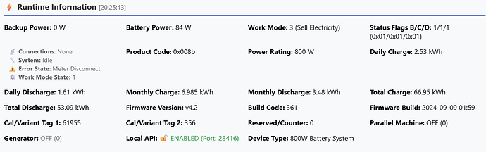

Made also a screenshot from the BLE tool, maybe it gives you a lead
Data from screenshot is from battery 05c6.

Thank you for the screenshot, it seems the port number for the local API has been configured to 28416. Are you able to change this to 30000, since that is currently the only port number that is supported by the Homey App… There is a request to have this configurable, but I’ve not been able to implement that yet. You can use the BLE tool (not sure what version) to configure the port number. If you don’t want to tamper with this number, you will need to wait until I’ve implemented that change.
Hi Edward, I tried already several times to change the Local API port to 30000 through the BLE tool (BLE–> connect to battery –> system –> Enable Local API (30000) but this does not seem to change anything as it stays fixed at port 28416. I’m afraid this could be/is the problem. Hopefully you have some time to be able to make it configurable.

It seems that version 2.x.x of the tool does not change the API port nummer, but version 1.x.x (stable version) does.
At least in my (very limited) experience.
It doesn’t help me though, still the v3 isn’t found. Back to modbus for now.
