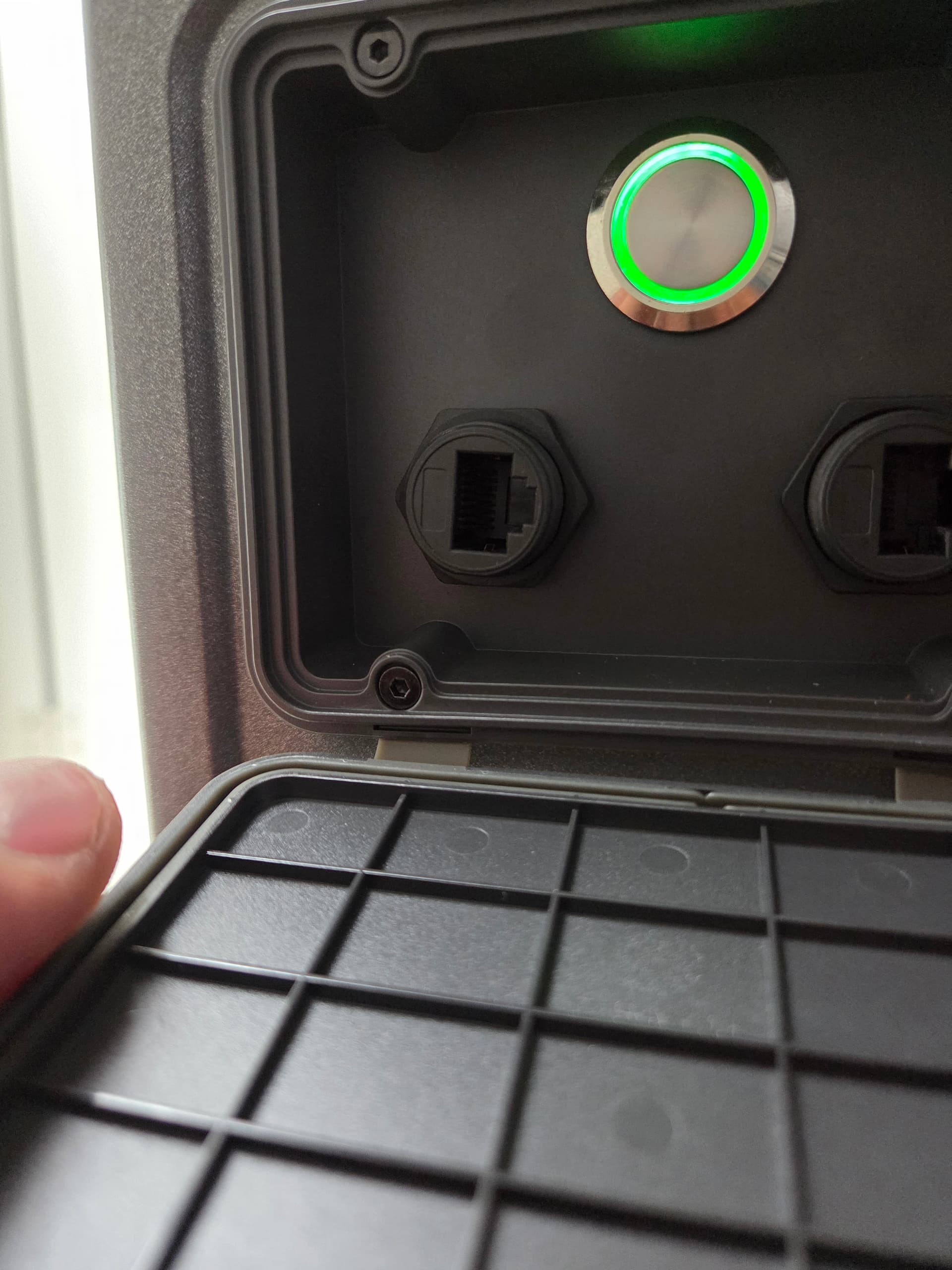

On my Marstek Venus 3.0 i have this port for modbus. Can You tell me how i can use this with your app? And i also wonder why you don’t use the api way?

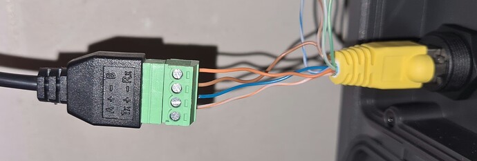

I used a EW11 device, you connect 4 wires from the modbus cable you received with the battery and screw them into the cable you get with the EW11, pair the EW11 with your network, default settings and it should work. 100% full fast direct local control. It is also powered by the modbus port, so no external power required.
Please check the wiring schemes in those threads based on your battery version it slightly differs.
i only have this port and no cable. So i wonder is i neede the ew11?
I have the v2 so can’t really help on the wiring trick for the v3, the rs485 port is the one. Check the tweakers forum for v3 wiring instructions.

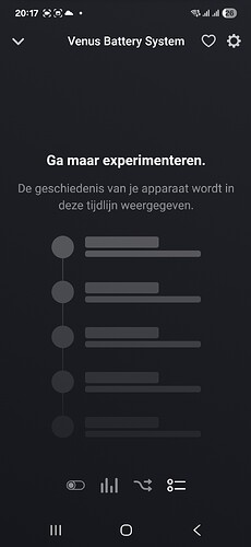

A message keeps appearing on the screen. The device is temporarily unavailable.
Maybe a video better for you to understand but can’t upload a video here.

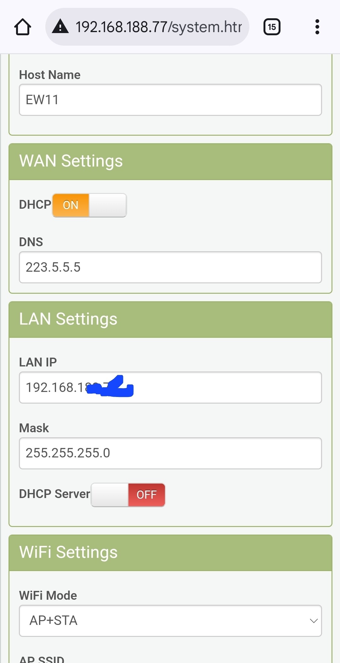

I see you setup port 80? That is a weird port for the modbus gateway, default it is setup on port 502. The 80 is normally the web ui to manage the ew11. Can you confirm in your EW11 settings that your Communication settings, ensure the settings from the tweakers thread are there ok also, just like on the serial settings page.
I’ll try-out to set it up right.

i did this.
bud it won’t work.
There must be a mistake somewhere that i can’t find.
I don’t know iff this is right?
Did you do step 7? And in my app you matched the port etc?
