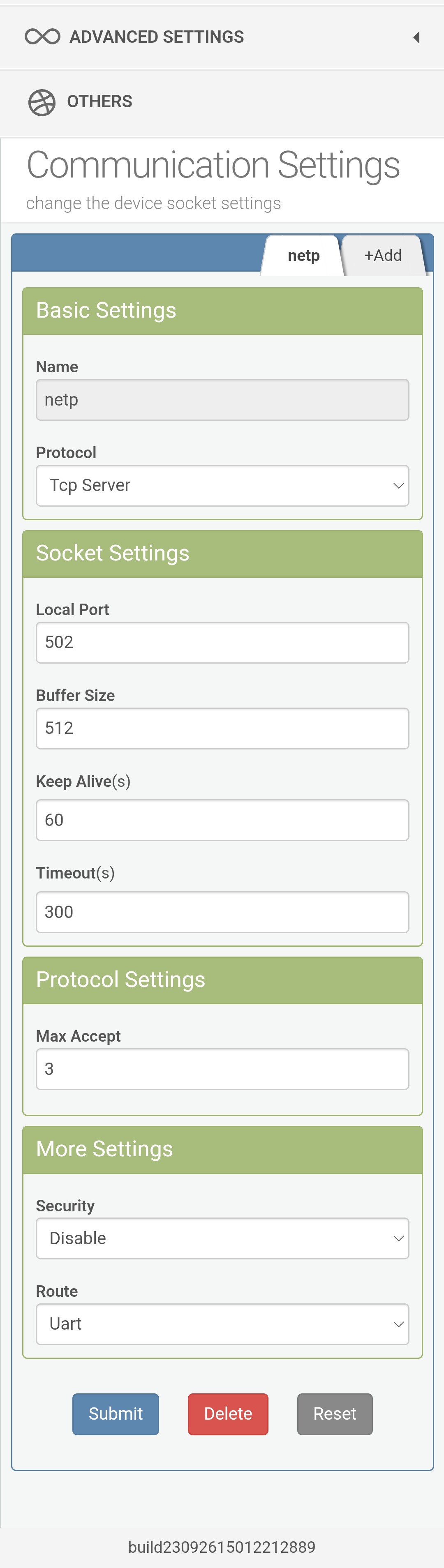

can you share a screenshot from your communication settings page?
IN the log I can deduct your IP and port seem to be setup in line with your screenshot earlier. But it is unable to connect. So my app is just getting connection timeouts to that IP and port, so the EW11 itself is unreachable by the Homey the app is running on.
I don’t see anything wrong.
I hope you do!
I do think that’s the problem.
I can only reach the ew11 when im on the ew11 ap
Then your wifi setup is not correct, check those steps again in the forum, also when done reboot the ew11.
So it includes setting the ew11 to the right AP info from your network, then reboot

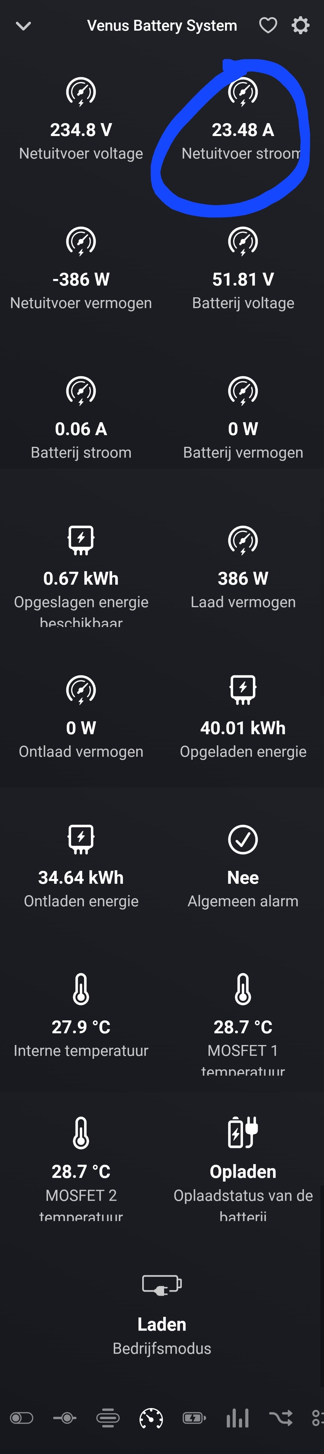

Started from scratch again and now the Marstek is online in Homey.
Everything looks good.
Only the Netuitvoer stroom isn’t right.
You told me not t push any buttons yet, so i won’t !

I’ll check the grid power one, see if that’s a big for me also

Back-up power on/off works fine. The rest doesn’t work.
