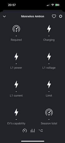

Today I’ve added several devices to my Homey Pro.
Most of them I’ve managed to get working.
But my MENNEKES AMTRON charger does not show any connectivity data.
I know for sure the correct IP-address. I can connect via the browser, check settings and so on.
The latest version is installed onto the charger ( V1.13 ) .
Remark : I do have an SMA Home Manager 2.0 that manages my SMA Solar invertors, SMA Storage ( Home battery ) and that SHOWS my Mennekes Chargers functionality.
In my SMA invertors I had to activate TCP ( Port 502 ) to get their data into Homey
Are there any screen-shots available from an operational Mennekes AMTRON charging station ?
I’ve gone through all settings I can think of, tried some but no joi.
Thanks for hints/help to get this resolved.
Walter
modbus is only supported on amtron professional and premium models

I do have an AMTRON XTRA PREMIUM model.
Just added a PICTURE from my device, inclusive some data from it. Hope it’s visible.

Possibly here a specific setting ?
then you should be able to connect with a modbus scanner from chipkin for test

So far, I don’t get any further.
This MODBUS topic is for me a bit overkill I believe.
Also, don’t see directly any added value. My Mennekes Amtron charging station can perfectly be reached by me from my computer ( to see possible settings… ) and I can reach it perfectly with my APP ( Can modify between charging via Energy Manager, Manual or Time-based ) and when I’ve selected the Energy Manager mode, my SMA Home Manager 2.0 can perfectly modify the charging levels according to the amount of extra solar-energy there’s left.
Could I pass some screen-shots from the charger ?
Or can you help me a bit more with this MODBUS topic.
Now I’ve tried to install that program on my computer. Then I need to scan the network.
I select the network where my Computer is connected to as well as my Homey as well as my Charging Station. But the tool stops…
Any idea’s ?
sma is using the HEMS protocol for their energy management.
You can enable modbus under netwok settings. See:
https://www.mennekes.nl/fileadmin/MEN-Deutschland/emobility/01_documents/04_installer/IA_Aktivieren_der_Modbus_TCP_Server_Schnittstelle_v00_2021-01-18_de.pdf
you can try CAS modbus scanner, for example read voltage on register 222, length 2 (32 bit value).
or current on holding register 206, length 2 (32bit)
ID doesnt matted, the charger responses on any modbus ID.
