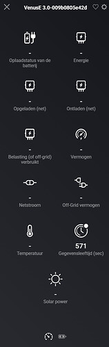

I’m very interested in exploring the possibilities of the app to control my Marstek V3. I’ve activated the local API and added it to Homey, but no data is coming through. I understand that others are experiencing the same issue. I’m using a VenusE 3.0 v122. Thanks in advance for the developer’s work!
If resetting the battery does not help (see troubleshooting) can you enable debugging (settings of battery device) and send a diagnostics report through Homey please? Perhaps the logs can explain somehting for VenusE v3…

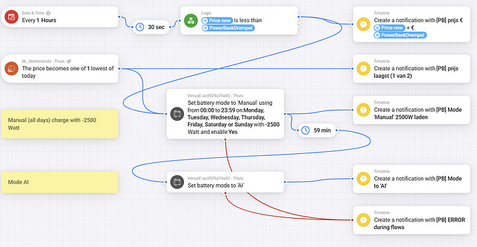

I’m currently switching between Manual and AI mode using the following dynamic flow configuration:
I performed a reset using the BLE tool. However, no data is coming through. I have enabled the debugging checkbox. 1467db49-8cbd-465f-a66e-1d2dcfe17f5b

Hi Eniewold, currently added 3 Marstek Venus E 3.0. This went ok but I can’t get any data out of it. Not sure if its related to the UDP3000 port (which I set in the BLE tool) API is enabled but stays on 28418 also after changing. Diagnostics report: 686b5d0a-86cd-4b37-aabe-35467708be64.
I did some additional checks, seems when playing with the flows I can switch between states (ie Manual or AI mode) so connection in that sense seems to work.
same thing here!
Thank you for the report, it seems the Venus E 3.0 does not react well to the broadcast messages from the Homey App. I have not tested on Venus E 3.0 since I don’t own this version of the device. I can’t find any difference in the API documentation, so I will try to investigate other local API software solution to see if there are differences.
